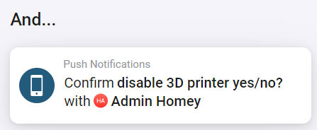

is there a way to create notifications with buttons so that you can confirm a notification. You could then use this to control something!
for example:
when the 3D printer is ready, send a notification with: disable 3D printer yes/no! If you press yes, the 3D printer turns off, if you press no, it stays on.

now the next question! I now receive this notification, but how can I ensure that I control a device when I press one of the buttons? I’m quite a novice when it comes to this!
How do i make a good flow with it?
