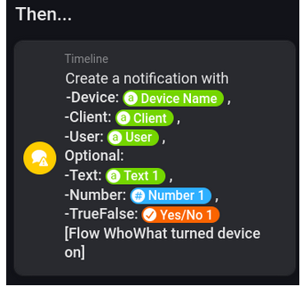

The ‘tag’ icon on a flowcard shows it holds local tags. By hovering with your mouse, you can view the available tags, but they’re also visible and selectable from the Then card:
The flow:
The Device is the device you’d like to be monitored, in my example it’s “Lamp Stereo”

Triggercard at mobile app:
Capability you want can check (it only shows the available capabilities for the selected device):

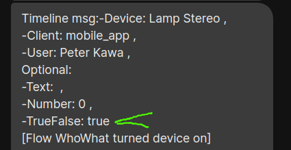

Output examples:
Watch the TrueFalse values, true (light turned on), and false (light turned off)
Client: Light was operated with the mobile app:

With your help, I just set my card-based flow as follows:

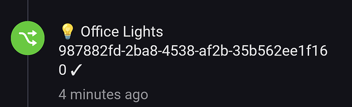

Testing it with a manually turning on the lights at the switch, produces this entry in the timeline when switched on:

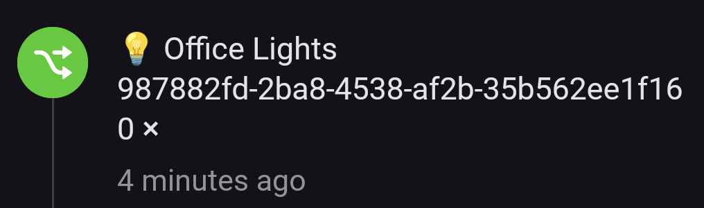

, and this when off:
How should I interpret the result? I guess the first two are the device name and device ID. Is the zero comes from the "Number " tag? And the tick is showing if it switched on or off?
Would something for ‘Client’ or ‘User’ show any app that is involved in switching the device on?
It seems like it returns the device ID a number and a tick indeed :upside_down_face:
I’d recommend to add the tag descriptions in front of the actual tags like I showed earlier, so you can discover what belongs to what

When the actual switch is operated, it does not know about a client or user.
Try switching it on using the web app for instance, it should return more info about that.
