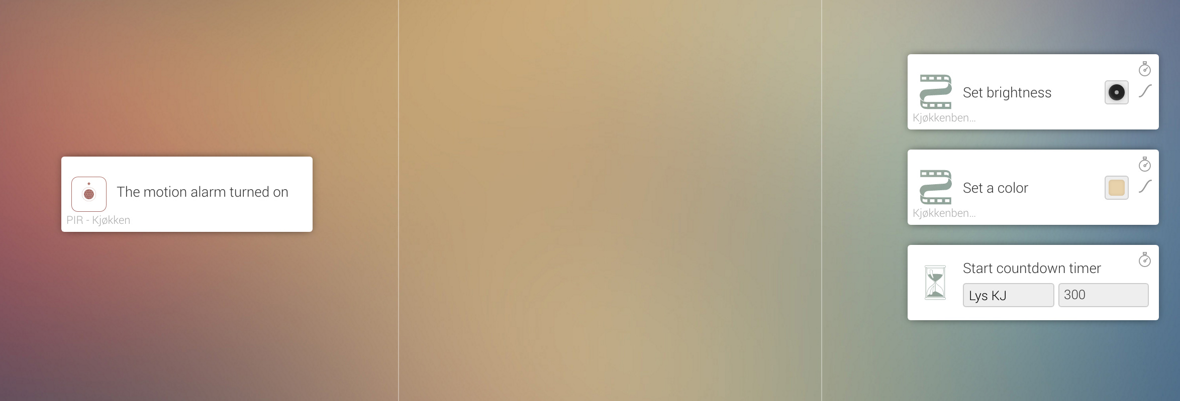

Does anyone else have problems with the countdown app? Have been using it for the past year with no problems. But all of a sudden when I create a flow to start the countdown based on a motion sensor I get -1… Tried with 3 different sensors, reincluded devices, and restarted the app. But, nothing works.
Can u post a screenie of ur flow and maybe check if ur motion sensor is not being stuck in motion?
Yes. Done this 30 time before and it has worked, so this is weird.
Tried with Neocool cam motion sensor, Aeotec multisensor, and hue motion. All the same
Maybe try to add a notification to ur phone with the flow. Or are the strips acting ok and it’s just the countdown card?
Did that as well, without to much luck. Got in a few push messages from the sensors, but not all. But when it worked I switched the flow to turn on the lights, and then I didn’t work anymore. So I really don’t know wether its the sensors or homey, or the app. Tried changing battery today as well, but no luck
