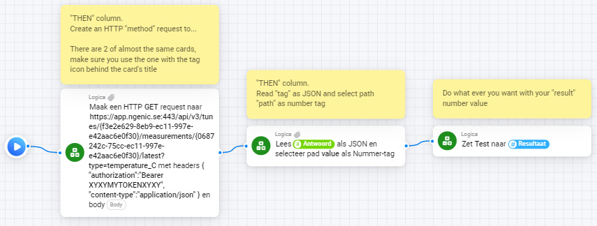

Haven’t used the http app in a while, the build in logic send http card had seperate inputs for URL, body and headers, when I’m at home I can give you an example.
You can’t extract content from the responses with the built-in Logic card.
As long as the response is JSON, yes you can, with Homey advance flows it is really easy.

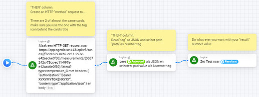

this should do it:
URL:
https://app.ngenic.se:443/api/v3/tunes/{f3e2e629-8eb9-ec11-997e-e42aac6e0f30}/measurements/{0687242c-75cc-ec11-997e-e42aac6e0f30}/latest?type=temperature_C
Header:
{ "authorization":"Bearer XYXYMYTOKENXYXY", "content-type":"application/json" }
Edit:
if you want to be safe (if their service is offline for example, kinda forgot to add it into the example flow), you can add another “AND” card between the request and reading the JSON, and see if the “status code” (number) is 200
status 200

Something wrong with the Header…
Homey Pro 2022-09-23 08-24-15
Please try “Authorization” and “Content-Type” with capital letter. Perhaops the Logic is checking case sentive.
Source: HTTP headers - HTTP | MDN
The issue is that the example is showing the headers in JSON format, while they should be in plain text (with line breaks in between the different headers).
