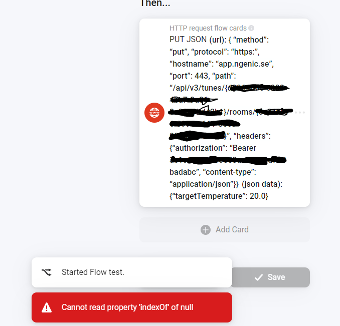

Hi again :slight_smile:
Thanks alot now i understand. I managed to get hold of my Uuids so i think i got it right now.
I had to reset my password for Ngenic since i couldnt log into the developer altough my password worked for normal Ngenic use.
But it didnt work i just get a error message…
Hi Great tip Markus
I have done the same and have the same error message as Mikael :frowning_face:
Note sure what the error can be. I remember having troubles setting this up. Perhaps there were multiple ways of doing a JSON PUT? Think it had to be an A40 request, see HTTP request flow cards App for Homey | Homey. You see the A40 info when editing the card on the phone but I cannot see this in the web interface.
I see that the title of your card is “PUT JSON (url)”, while my card just reads “PUT JSON” in the beginning. Perhaps that’s related?
