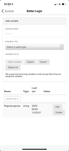

I’m not sure what to insert in the search field and in the green json field als variable? Do i have to make a variable first in better logik?
Thanks a lot
You first have to make in better logic the variable Regenmenge heute. The get request i called it Niederschlagmenge because i assume you can only put in one word and not more words.

hello @Marcel_Ubels,
i did exactly how you sayed:
https://homey.app/f/82ssr7
https://homey.app/f/i4Bsr7
But i always get this error message:
Thnaks
Philipp
Can u also try to start the flow instead of test the flow?
it works, i pressed test, thanks
