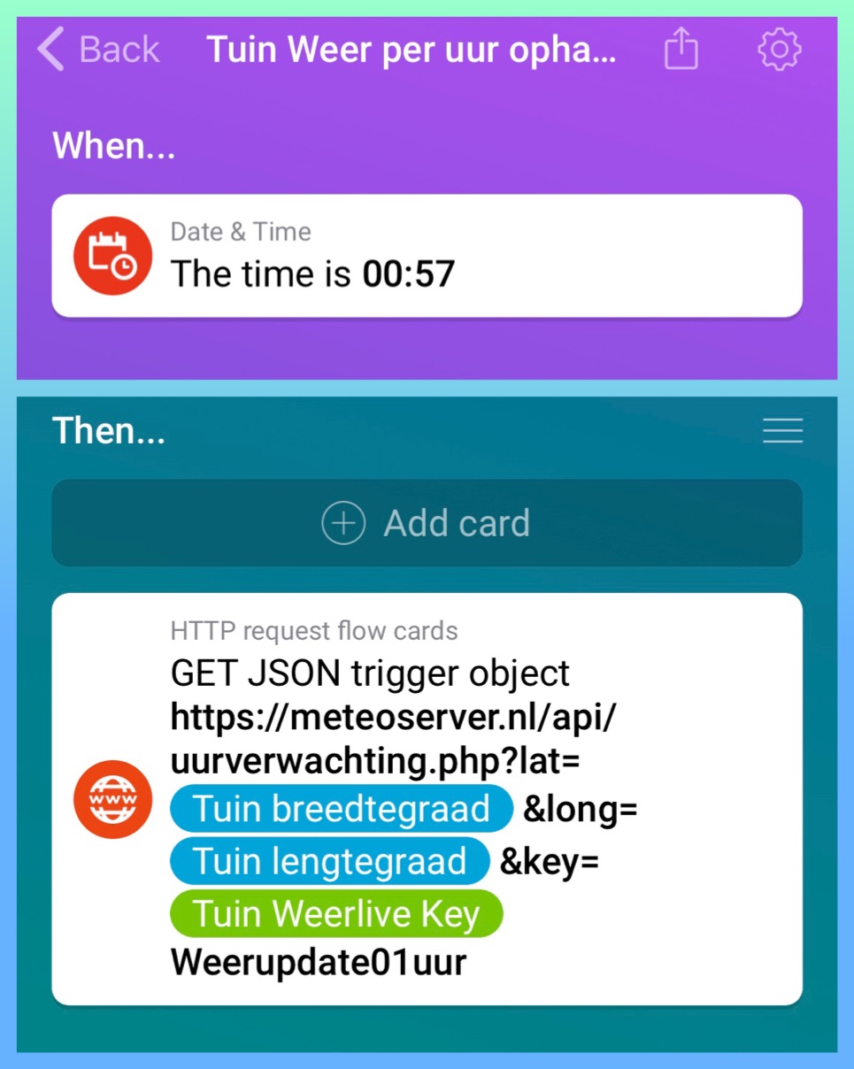

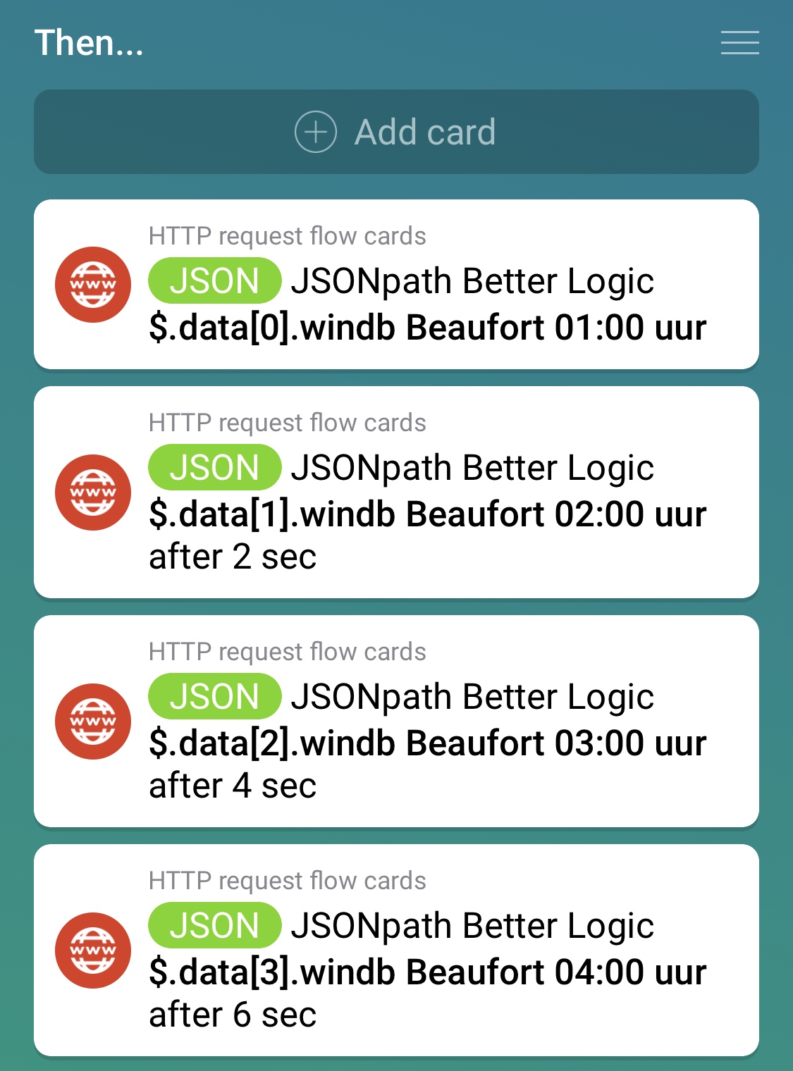

You can find some info in Dutch here;
Thanks Marcel, this is very helpful information.
