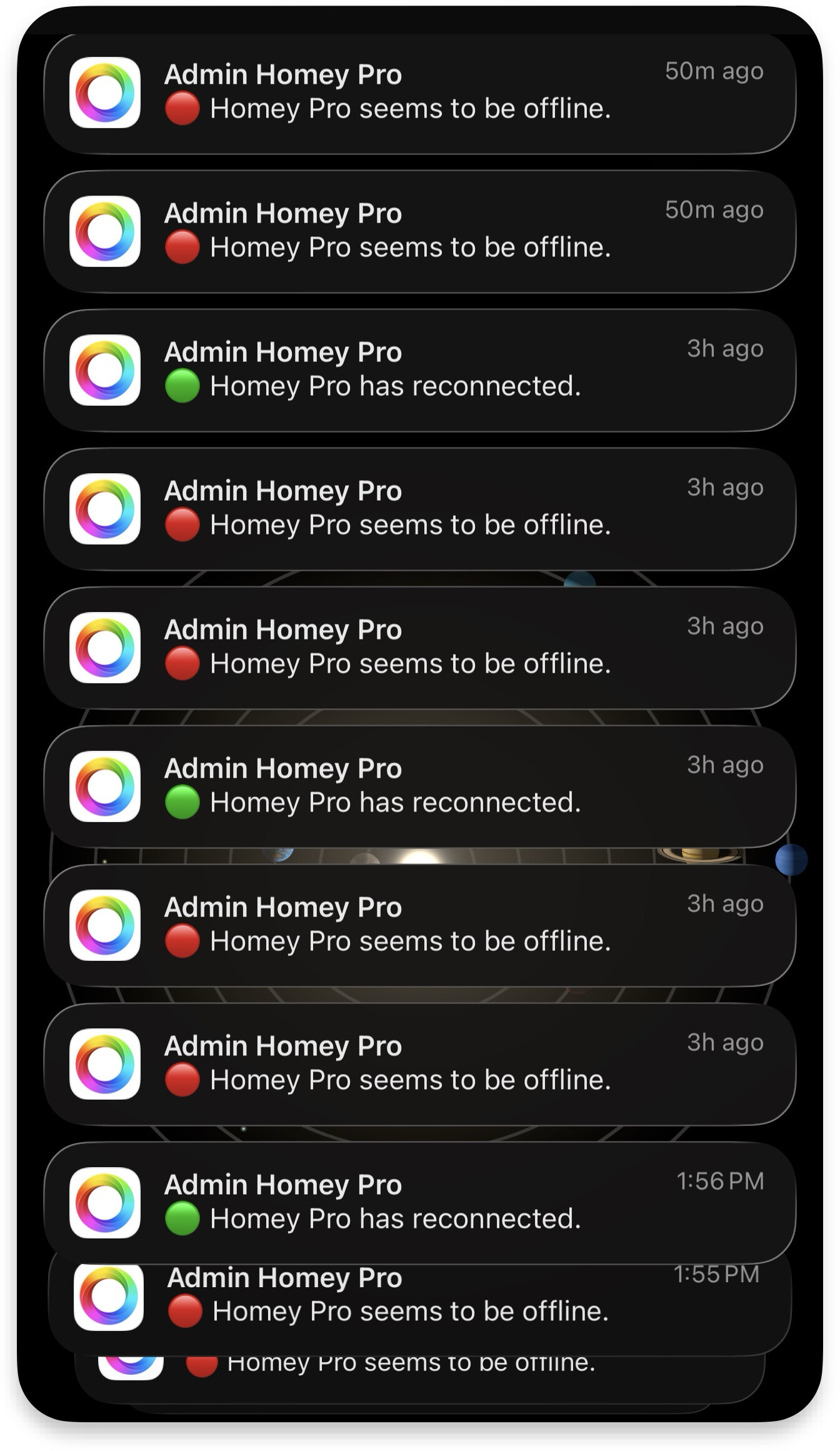

Pro 23 multiple Offline events today
Is been like this almost every day but only once or twice offline notifications, but today have been not stop the offline notifications. Everything else in the house wifi related has been working fine. The Homey Pro is about 10-14feet away from the Wifi routers. There is great wifi coverage in that area.
Would this mean the internal Wifi chip is bad and is time to get the Ethernet adapter.
As I was looking for the version went Offline again so could not see but it should be the newest one.
