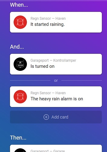

Made an flow if my garage port is open, then close it. :slight_smile:

I think your flow contain a useless condition.
When it’s started raining it can’t be already heavy raining.

Nope, The flow works as it should. But to much. :laughing:
But i can see that you mean, and heavy rain is now gone from the flow.:shushing_face:

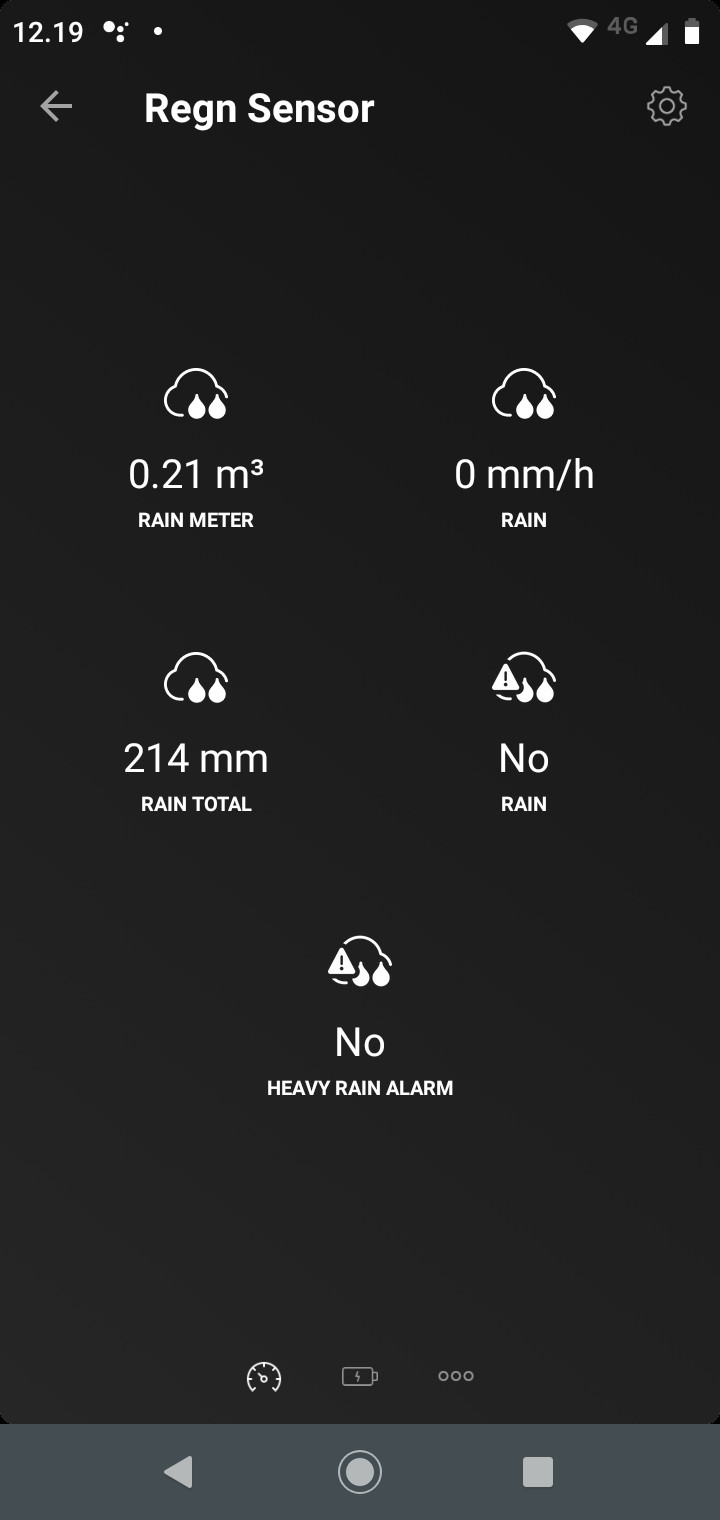

How can I calculate mm rain/day ? I would like to automate my irrigation system and it shouldn’t turn on when the rain exceeds x mm during the last day. Also, what’s the difference between “rain meter” (m3) and “rain total” (mm)?
I think you should ask the developer.

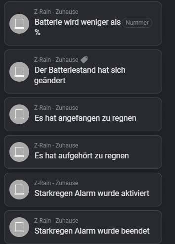

But I got some information from my friend. So these are the available trigger flow cards (sorry, only in German):

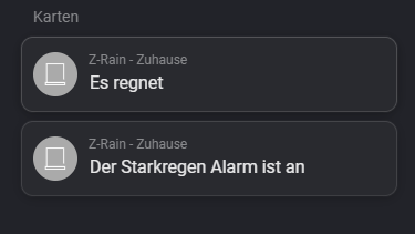

These are the available condition cards:

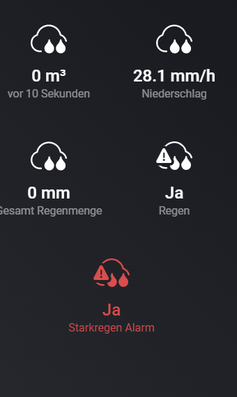

And this is the device card:
My friend said, that the precipitation value (Niederschlag mm/h) will be reset after rain. All other values will be incremented further.
This method works only theoreticly.
Theoreticly you can send a Z-Wave raw command at 00:00 o’clock to reset the Rain Counter. But the problem is that the sensor is a battery powered device and it is only able to receive datas from Homey, when it’s awake. So if you send the Z-Wave raw command at 00:00 o’clock and the sensor isn’t awake, the Z-Wave raw command will be stored in Homey. When the sensor wakes up e.g. at 01:21 o’clock, the Z-Wave raw command will be send from Homey to the sensor and will reset the Rain Counter. After a certain time (I don’t know the exact time) the Z-Wave raw command in Homey will be deleted again, if it was not sent. So it is not controllable.
