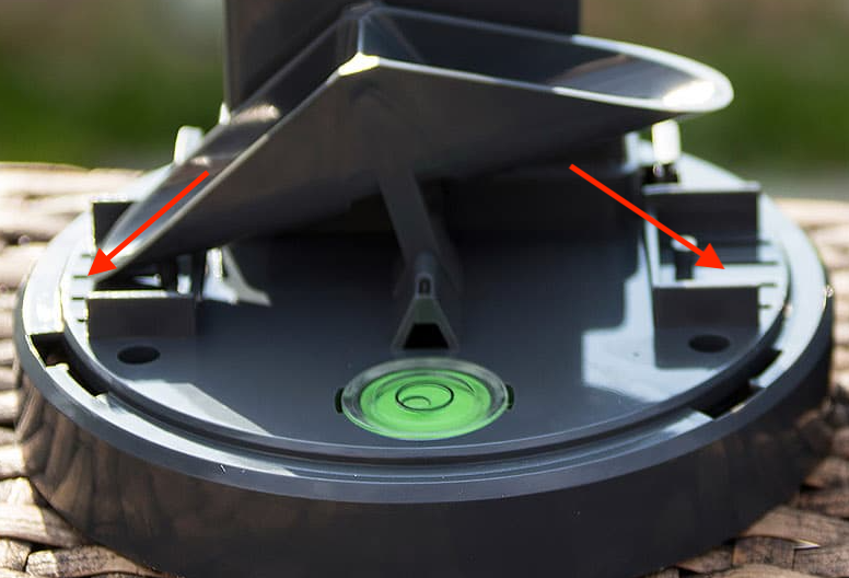

The only Z-Wave rain sensor I know that is compatible with Homey is the POPP Z-Rain Sensor. But it uses batteries and I have no personal experience with this device, sorry.
But I have the POPP Z-Weather, about 2 years, and the POPP Outdoor Siren 2, about 3/4 year, in use, and so far I have had no bad experiences with either device.
Note: Many rain sensors determine the amount of rain via a rocker with two paddles (see photo). In order to detect whether it’s raining, one of these paddles must first fill with rainwater and then tilt due to the weight. Depending on the strength of rain, it can take up to several minutes until the rain sensor recognizes that it’s raining. If you want the awning to close automatically at the first raindrops for example, you have to use a different type of rain sensor.

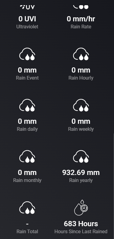

The WH40 and GW2000 should work OK. The batteries should last well over a year, probably 2 or more. I have the weather station with the solar panel and the batteries are still OK after 3 years.
The operation is the same as the POPP unit where the see-saw rocks back and forth as one side fills up followed by the other. Once the bucket is full the see-saw tips and empties while the other side starts to fill. This does mean they need to be mounted level for the action to work correctly.
The update rate from the sensor is around 15 to 30 seconds and provides the following (except Ultraviolet):
All of which are available in the flows.
Once you have the GW2000, you can expand the system to include moisture sensors. I have these in various places in the garden so I know if it is OK to skip irrigation based on the soil moisture content.
Note: the rain sensor doesn’t need to be mounted up high, like a wind sensor does, as it will catch rain in any space that is not covered.

When the rocker tilts, the water runs out of the paddle through slots in the bottom of the sensor.
Yes
Don’t know exactly, but this is what is written in the manual:
The base (1) contains the gauge and a indicator to place it on a flat surface.

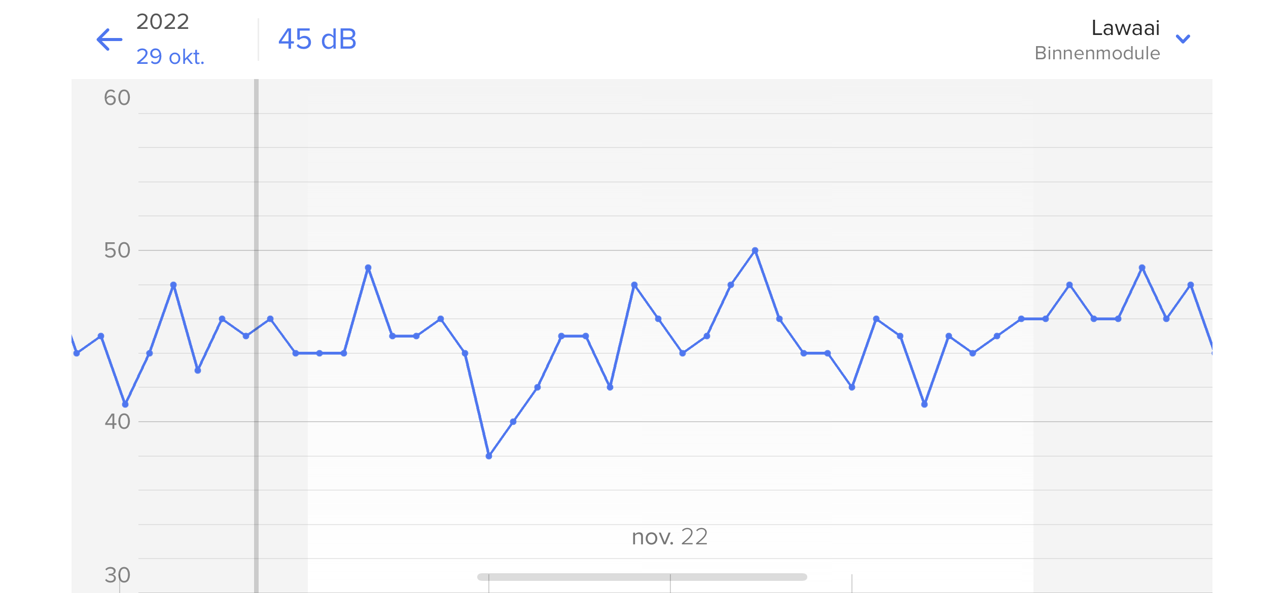

I own the Netatmo Rain Gauge(Wifi)I have the indoor and outdoor module. Works great. Outside battery operated, about 1 ½ - 2 years for the battery.
Rain gauge is self emptying. Everyday restarts @ 0.00mm. Has his ownn app for Homey and netatmo’s own app for your smart phone. As noted it also has a tumbler. It takes some while before it tumbles the first time(mostly 0.1 mm), so no direct guarantee it starts to rain.
Works pretty ok for me for years now.
Indoor module( nescessary, the rest is optional)
Outdoor Module
Rain Gauge
Netatmo’s App

Yeah quite pricey, but works good. But including a co2 meter inside, moisture meter in and outside, thermometer in and outside and noice meter. The noice meter has no value for me, because it doesn’t mute( my wife).durability is very good(have them about 5 years), only the mounting kit for the rain gauge is not that durable because it got broken after three years.( screw broke)
