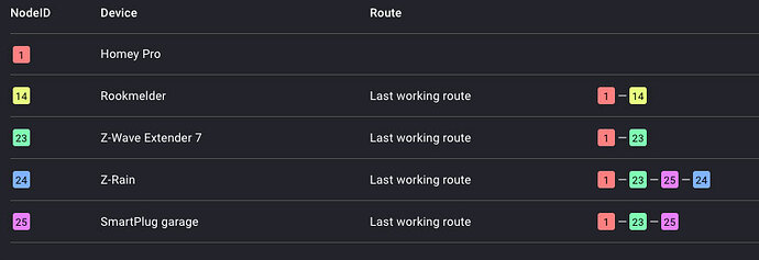

Do you guys have the same? It’s not working like this to replace the batteries this soon every time, but maybe it’s something else causing this? I placed it on the roof of my garage (flat roof) and it takes some “hops” to get to the Homey Pro (2019) via my other Z-Wave devices;

Unfortunately I have no clue why you see this issue. My meter is about 20 m from the Homey2023, with a few routers nearby. Do you have any z-wave routers close to the meter?

Yes see on top for the last working route. It uses the Z-Wave mesh via a Aeotec Smart Switch 7 and an Aeotec Range Extender 7.
