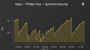

  3. I’ve got back into SetInterval, but with usage of EventEmitter (as every Homey Devices implements this class). -> memory still rises, in the slowest way but still quite fast (attached is the screenshot from my insights).
The question is how to get rid of those memory rises, how to get garbage collector to clean up the mess. Or is there totally different way of making the pooling done in such a short intervals with so many devices?
What also is weird and you can see it on the screenshot is that the memory sometimes rises faster, and sometimes slower - I don’t see any reason it is not in the same way whole the time. The App was restarted yesterday 19:00 so you can see how fast did it consume memory until this moment.

The App Philips Hue (Hue Bridge) has a very similar behavior?!
This has all the hallmarks of a memory leak. It might be in your code, in code that your app is using (like node-fetch) or in Homey’s core code. Try commenting out blocks of code from each of those parts to see if that stops the memory usage from growing.
Hmmm… On my installation Philips Hue works alright (18 bulbs plus Friends Of Hue switch)…

In this graph, the memory usage seems to settle down after a while. Have you tried running it longer?
Yes, I’m trying to investigate it a bit further. It’s really weird, because after a while the memory has been freed in some part, but then it started to raise again. After 24h it was around 40MB…
BUT I restarted the App and then it started to behave totally different - it was stable at around 18MB for many hours (a bit up, a bit down -> memory allocated, memory freed). So I restarted it again to check what happens and then for a few hours it was stable (at around 22MB), then it started to raise, then it again became stable (at around 35MB)…
Totally weird. The same code behaves differently when restarted.
I also noticed that it behaves differently when installed on homey (homey app install) and differently when just run (homey app run) - in the latter the memory Is allocated and freed much faster (the “teeth” on the graph are much shorter).
Then I tried another scenario - I lowered number of devices using my app (I had 20, but I removed some from homey). And it helped - when the number of devices is up to around 10, the App behaves stable. So it looks like when there are more than around 10 intervals at the same moment, the app becomes unstable with the memory allocation. I will try also what happens when there are more devices (back to 20), but with lower interval (at the moment I used 1000ms, I’ll try more devices with e.g. 5000ms).
