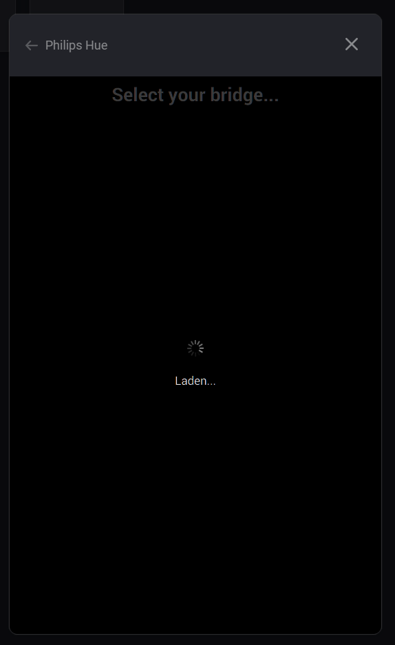

Trying to (re-)connect, adding the sensor to devices fails:
The cursor keeps on turning without any result, also when trying to add new Hue-bulbs. All the other Hue devices are working correct.

The Homey Hue App has found the Bridge (second picture), and there it stops (third picture)
keeps on loading with no result.

  • Why does connecting not work (third picture)
