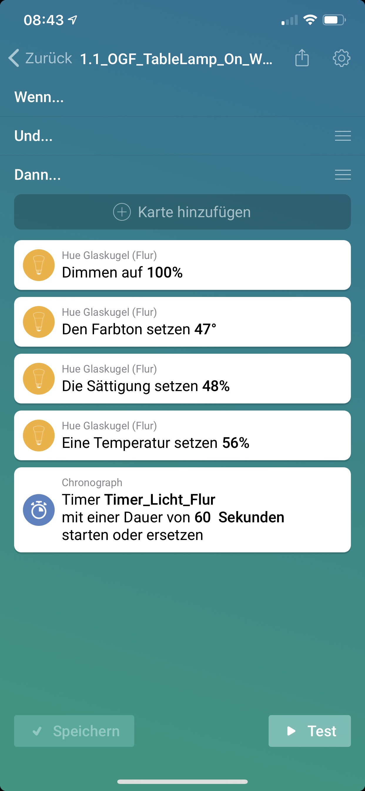

Thank you fantross. The dev consol was helpful. I set the desired shades of white and took over the data from device section to my flow. A little bit laborious, but it workes.
Now it looks like so:
