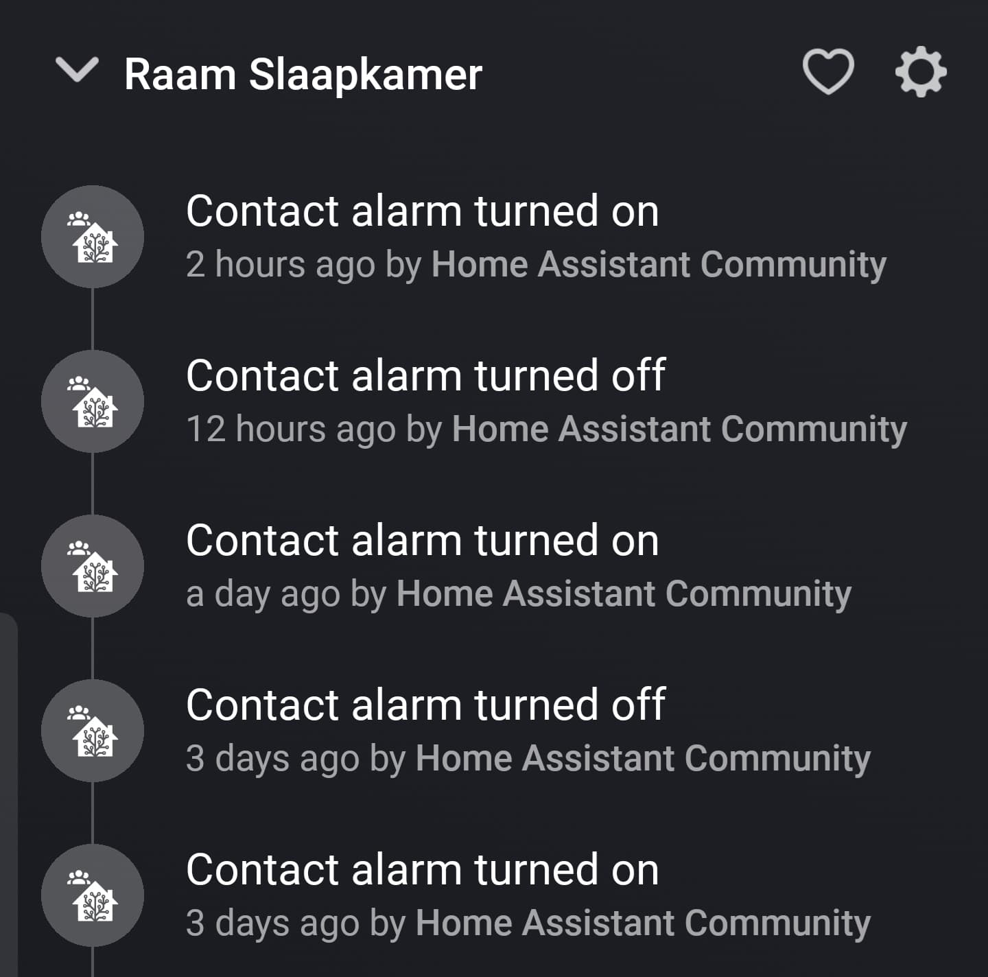

Thanks for your reply, the contact alarm goes off in an amount of time, like 2 minutes.
Alarm is than off but the door is still open.
In hue the door status is open.
The alarm seems only an alarm signal to mount an acoustic signal on it.
I would like to use the door open status.

Hmmm, that’s odd. My Aqara + Sonoff contact sensors do report an alarm for as long as the contact is open
(I know they’re now HA devices, but it was the same when I had them paired with Homey zigbee)
