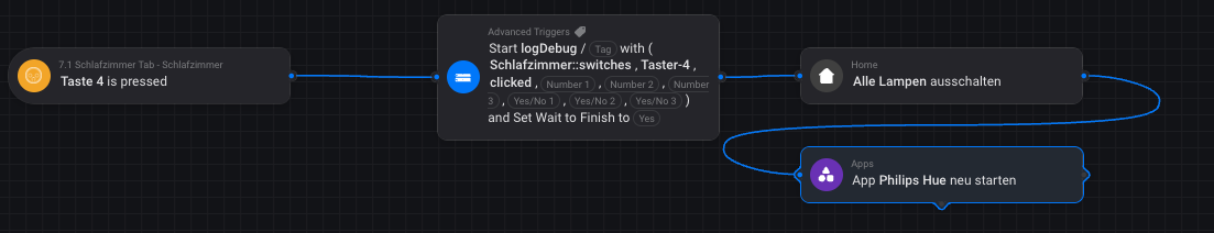

Mach im Moment jeden Tag einen Neustart der App über nen Flow.

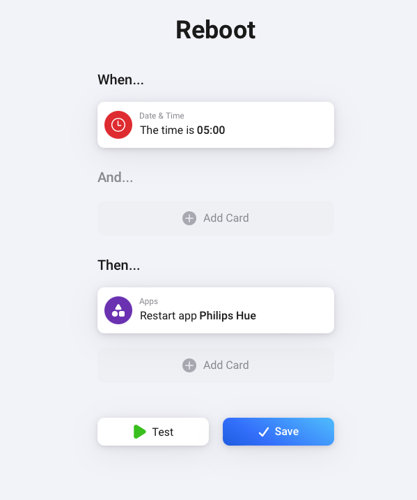

For now, there is a temporary workaround so you don’t have to manually reboot the app every time. Please enable the Power User Experiment on your Homey Pro. To do so, open the Homey app on your phone and go to More…-> Settings → Experiments so that you can enable this Experiment.
Once this Experiment is enabled, you could create a Flow that reboots the Philips Hue App daily at a set time (see screenshot for example). This is obviously not a final solution to the issue, but in your case it could be a temporary solution to the issues you are experiencing with your Philips Hue devices.
