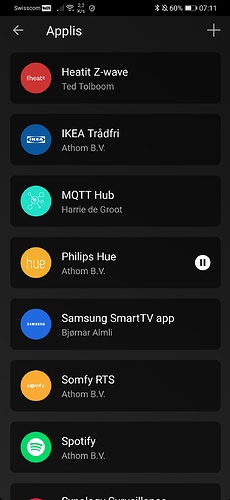

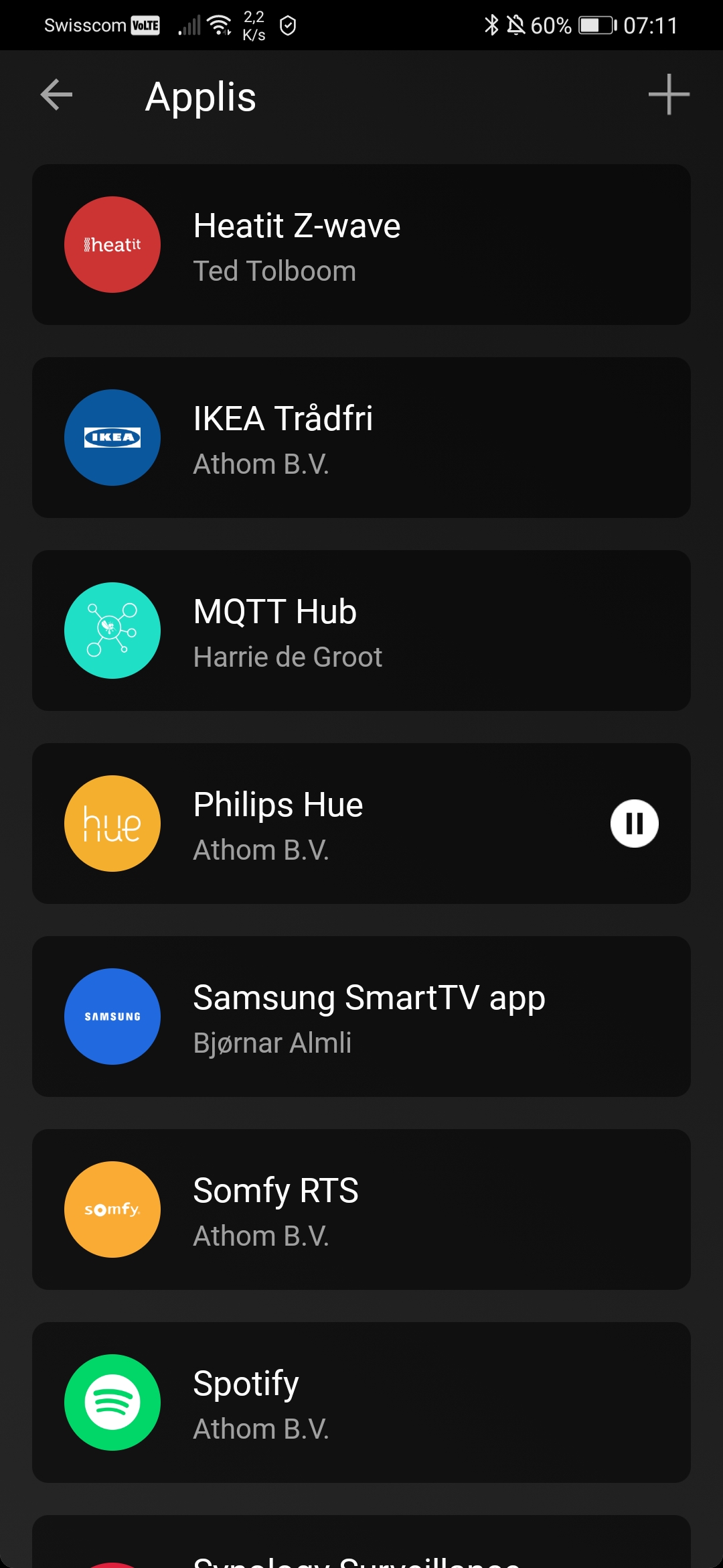

Thanks for adding that. Indeed, I also have the pause icon in the Hue app.

I tried the PTP for 15 minutes last night. This morning the app was paused again and all devices were offline in Homey.
