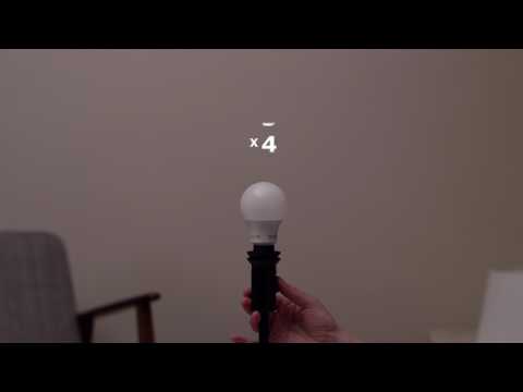

Thanks for your answer, but I think the real problem is in the resetting of the bulb properly.
Take a good look at this video and follow exactly their procedure.
After following this the bulbs paired without any problem !!!
