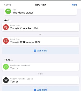

Hi all. Is it possible to, in the if function, to make an or function. Or is it only possible in advanced flow?
Yes it is possible in normal flows. Select the condition and hold it for a while, then the OR part will appear and move the condition to the OR part.
Now i have tried on both the phone and computer, but it is not working for me in the “when” part to do a OR function

These are the possibilities:
An OR in the when column is what a 2nd or 3rd flow is. (That’s why there is a “duplicate flow” option).
Multiple triggers is not possible in a single regular flow (not just a choice from Athom to not implement it, but how flows in Homey are written/designed in general).
The first (and only) implementation they ever could add to add support for “multi triggers” for normal flows is the device flow card like “[any] alarm turned on”.

In standard flow, this is only possible by using an advanced virtual device as flow trigger.
This virtual device can take multiple sensors, and it triggers the flow on any of those sensors’ trigger.

In the Dutch flows there are:
ALS
EN
DAN.
If you change the language to English, you will see that there is no “IF” section but a WHEN” section in the normal flow. I already complaint to Athom that “ALS” is a poor translation of “WHEN”. When you translate “ALS” back to English, it should be “WHEN”.

My question is if it is possible with more than one “If” in standard flow
Hilsen Claus Jacobsen
No,
standard flows have only one trigger (card).
