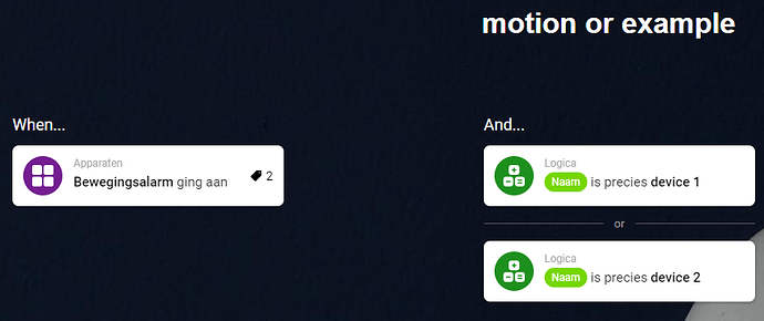

Just an example
You should make it like this (like robertklep told above)
