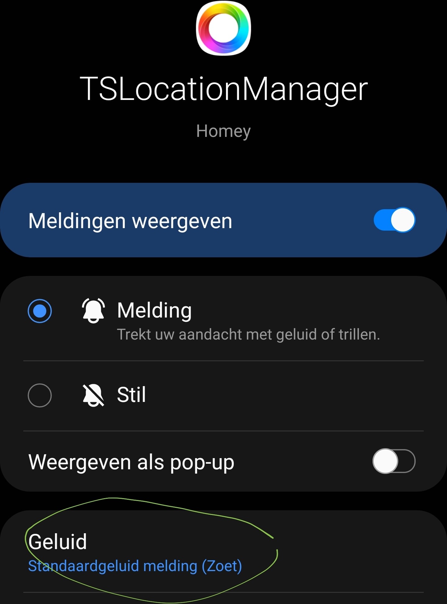

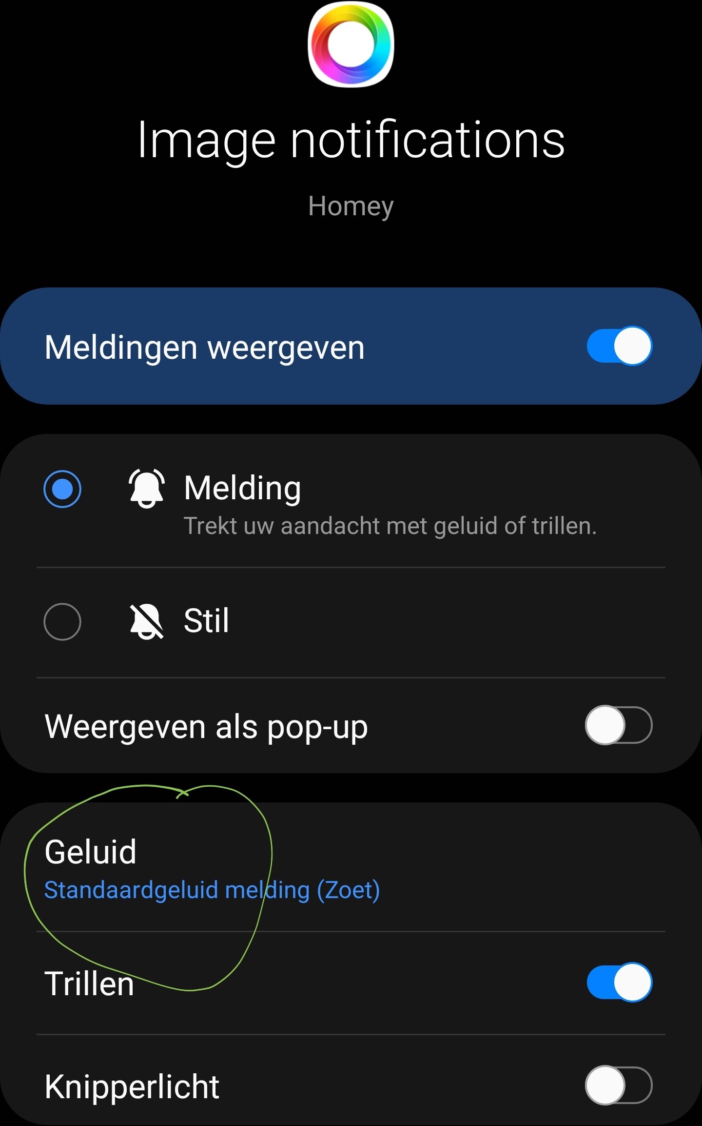

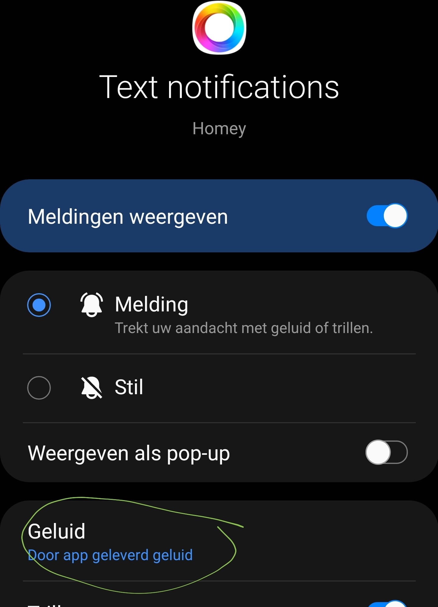

So I just checked, and the all sounds are the same: “Standard Sound”, except for the text-notification, it has a “Sound delivered by app” setting.

Aha. I didn’t actually go all the way into that sub-menu (it is easy to forget that even if there is a slider button on the right side, pressing the line itself gets you into a sub-menu), so it is possible that somehow the text notification had been set to silent (not on purpose), and when I wiped all the data to start over, I got all the default values again.
And now you also explained why that sound is different, it is simply because Homey for some reason decided to have that as a “Sound delivered by app” instead of the standard system sound.
Now I only have two categories as well, “Text” and “Image”. The other two (“Vibration” and “TSLocationmanager”) have disappeared, not sure why.

No clue what’s the reason, I also can’t find a sound setting for text-notifications from within the Homey app.
