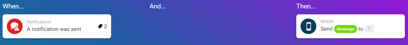

Send her a push message with the notification and ur done.
Now I feel officially stupid… :roll_eyes::grin:
Damn that was easy, thanks!!!
