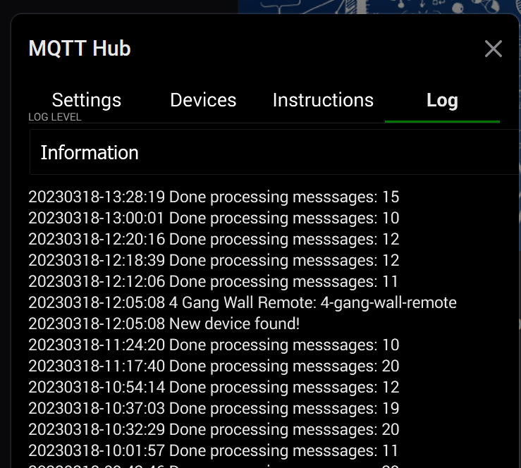

You can add a debug node in Node -red to see all messages coming in. That might be helpful narrowing down the problem:
The Homey MQTT Hub has also a log, but I don’t think it could solve your problem:
The Homey MQTT Client has also a log:
(All in the app settings)
