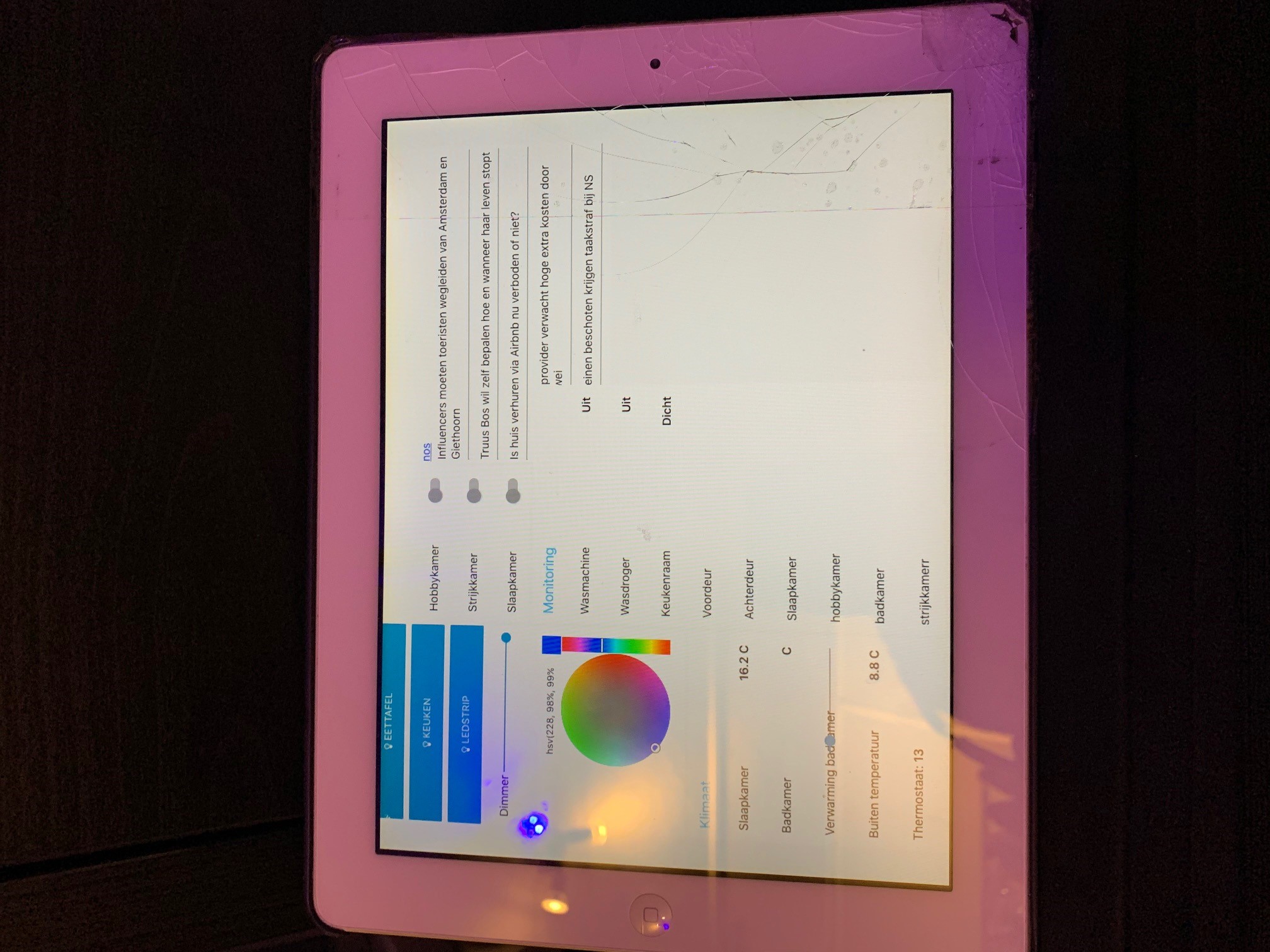

How did you manage to scale the Dashboard for your ipad. No matter how much i shuffle or change formats, it keeps looking like Frankenstein.
On PC:
ON IPAD 2:

My guess is that your iPad 2 is too old (specifically the browser).
@robertklep
I really wish that was the case. But unfortunately i have tried on a Samsung A10 tab, Ipad mini, Iphone XR and none of them are acceptable enough to use. I tried to move them around, change width, but there is just no way to get them properly alligned, or even slightly towards what @satoer has shown on his initial post.
I have absolutely no idea how you managed to get a totally different template on the ipad compared to the web browser.
It works fine on my iPad2 (the second iPad, not the air 2) running iOS 9.3.5
There are a couple of small problems though, that I still need to fix. The slider controls are less long than the should be. And sometimes the button’s don’t react on a touch, but got selected. The buttons have a “hover” state, and when you quickly touch a button it shows it’s hover state instead of a click. Probably a piece of javascript can fix it.
I did remove touch scrolling from the page, so the page does not slide up and down when you accentually slide your finger. Makes it more behave like an app. You can still swipe to a different tab.
if you want this: add this piece of script inside a (blue green) template node (add to the head section option):

I changed the color myself in between taking pictures, but that’s not the point. it’s the layout thats shifting like crazy. yours is properly boxed inside of a square. Mines looks like an unorganized compiled dashboard. i can try to disable scrolling, maybe it will automatically resize to fit in one page.
Are you using a content blocker or PiHole or something like that?
Nothing. We don’t have anything special installed, no ADD blockers.
Node red is running on Rasbian, on a Pi 3b+.
Tested on:
Iphone XR (both landscape / portrait mode)
Ipad 2
Ipad mini (latest)
Samsung tab A10
Rasbian internet explorer (Fits same way as desktop)
Windows 10 Chrome (shows correctly)
Should they normally look exactly the same? - i mean on Tablets, phones and PC?
the '‘result’ im seeing on the tablets is similar to the effect i have on desktop when i change web page size % (by pressing Ctrl + scroll wheel)
It looks the same, but the layout changes based on the resolution. On the iPad2 3 groups fit beside each other, but on my iPhone11 Pro Max the groups get stacked on top of each other (in portrait). On my iPad pro 4 beside each other (in landscape) and iPad air2 3 groups beside each other. On all devices it looks good.
These are the settings I used to fit exactly 3 groups beside each other on the iPad 2:
  • every group is “6” units width (or 12 or 18)
