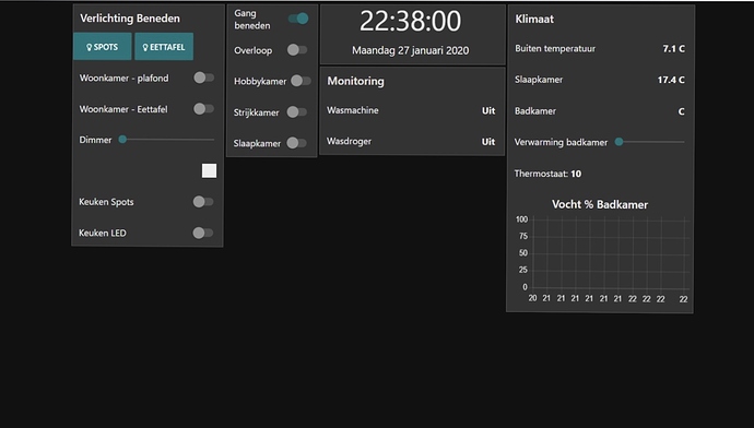

Ive been reading node red forums on how to style the dashboard, but as of yet i have only found options using a ccs and html. Is there any way for me to fill the dashboard without having to learn ccs? Currently i have a couple of switches and information set up. I would like to include my 2 hikvision cams (live stream if possible) and possibly an alarm tab later on. If i look at all the examples here on the forum they are all nice and square, but mine is blocky because i dont have more information to put in there. Is there any ‘filler’ or something for this?
Also tried to have time/day on top and all others nicely alligned a little under that but that also seems to require coding skills i dont have

You can adjust all the sizes of the grid over here:
You can also add things like buienradar.
In the lay-out section, you can add fillers to every group:

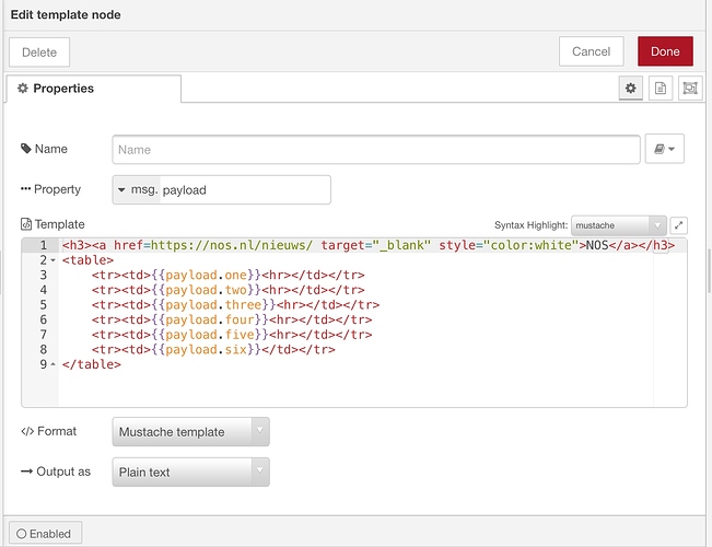

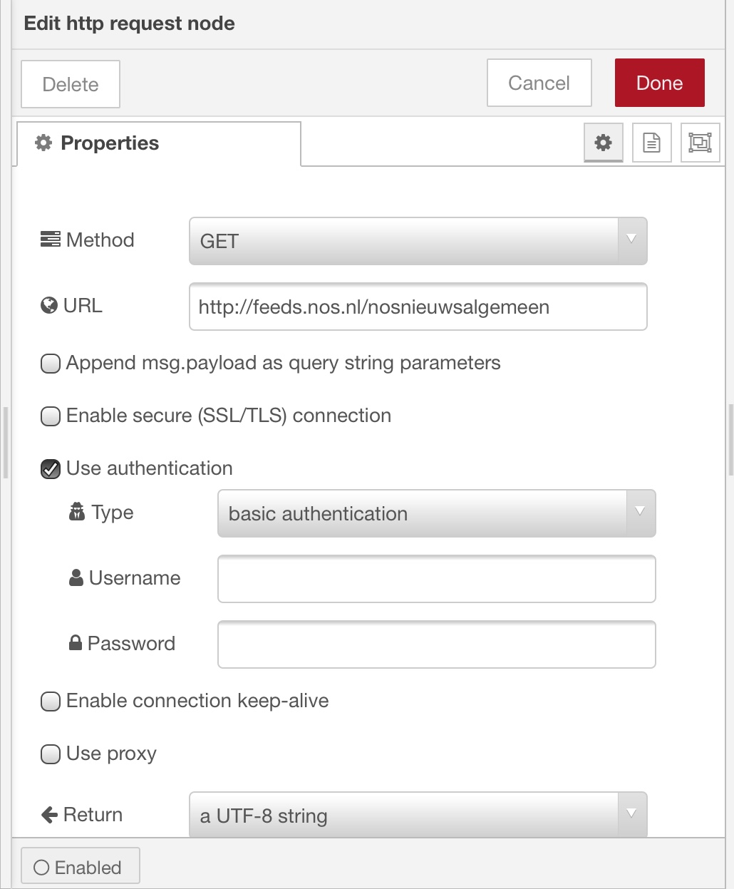

Hi Roy,
I used the HTTP get command instead of the RSS feed. The withdrawal of the rss is that it will only load the new items (so most of the time just one item)
Unfortunately I am not able to export right now, so hereby some screenshots.
The xml is just the xml node without any changes.
I have copied your exact setup, it works perfectly.
