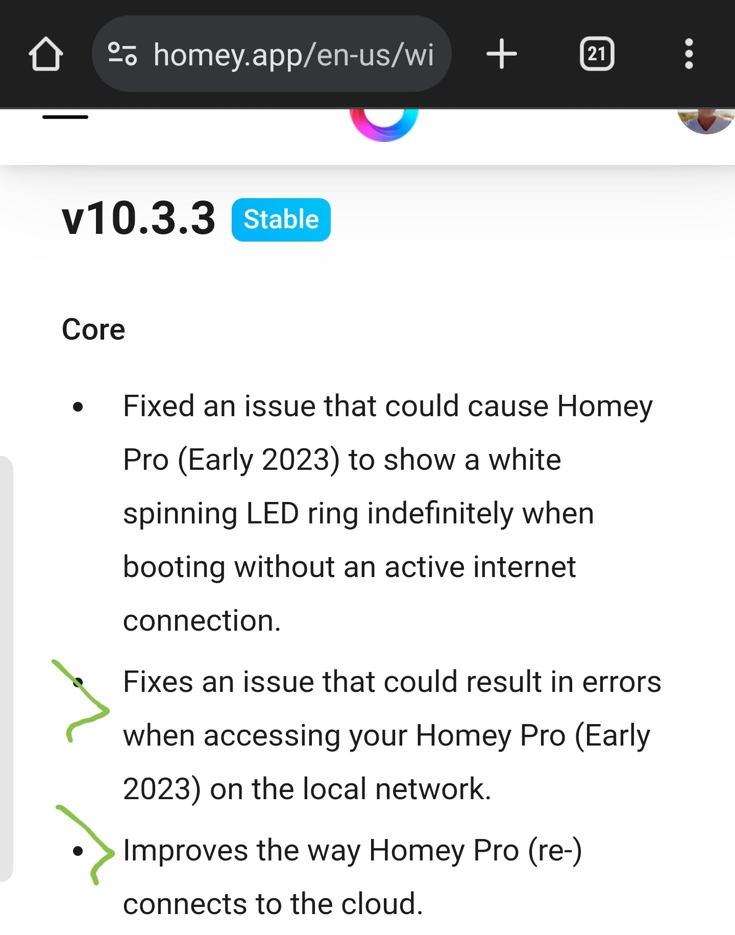

Ubiqity unrelated: LAN issues should be somewhat fixed lately.
Which firmware is Homey on atm?

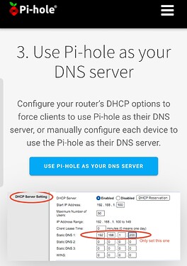

I don’t know the pihole, but I think it can filter out “too much” for Homey?
According to this info, you only use the DNS service from the pihole.
Random and reserved IP addresses should be handled by your DHCP server, often the one in your router.
