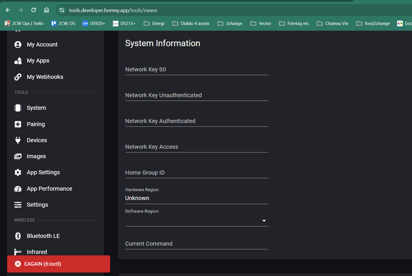

  • Except ”Hardware region unknown” no other information is available in the ”System information” under Homey developer tools - > Z-wave

  4. Z-wave never comes online, only referring to “Error EAGAIN (6:ioctl)”

  2. In Homey developer tools I tried to manually add EU as region for the Z-wave with a reboot but it did not change anything.
  3. In both my.homey.app as well as in the Android app I received the same error ” “Error EAGAIN (6:ioctl)” everytime I tried to do anything related to the Z-wave.
