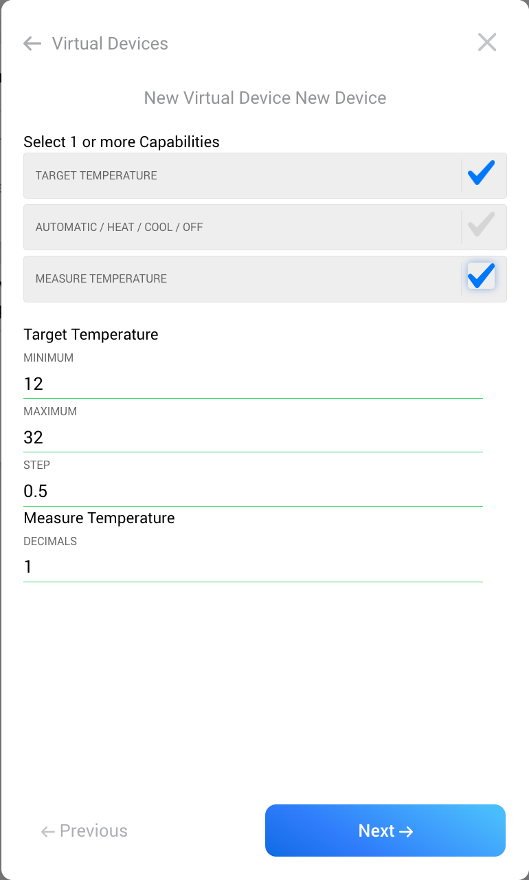

On the Virtual Devices app target_temperature is configurable for min, max and step during device setup.
So might be doable.
@HarriedeGroot, any chance we could have configurable limits for target_temperature similar to what is available in Virtual Devices? Either from the advanced JSON configuration and/or during setup of the MQTT Device when Target Temperature is selected.
Created an issue at github: MQTT device target_temperature configurable value min/max/decimals/step capabilityOptions · Issue #82 · harriedegroot/nl.hdg.mqtt · GitHub
Updated the issue in Github with further ideas.
