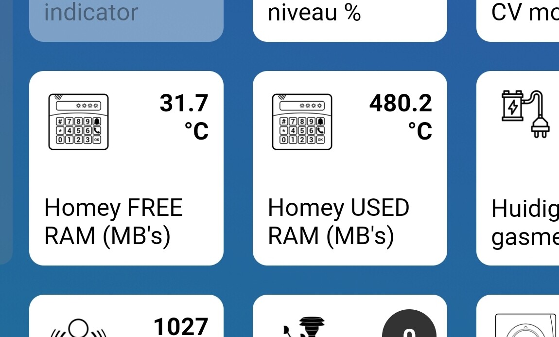

See my ‘abuse’ of thermometers as MB indicators…

How I got those RAM values, is done using Homeyscript.
I’ll be happy to share if you like.
Yes please, Aleta nice even though you can’t really do anything with it right?
Just for entertaining and informational purposes :wink:
Although it is possible to start a flow which reboots Homey if RAM is below X MB’s… But I like a warning better :wink:

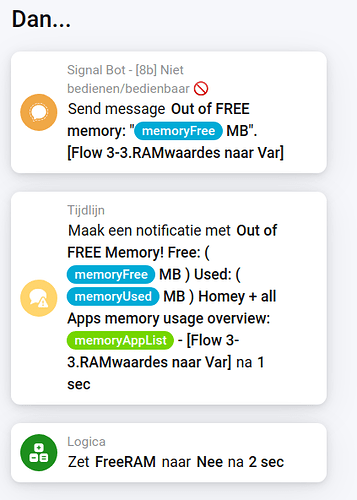

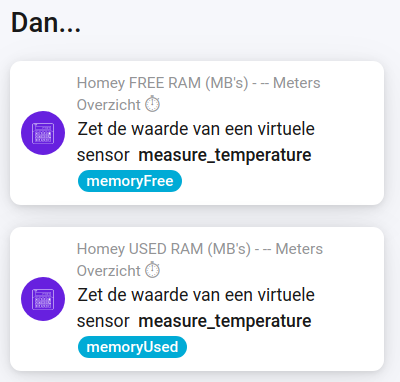

Flows:
Flow 1
While HomeyScript tags aren’t shown in shared flows, a screenshot of THEN:
Screenshot from 2022-01-28 14-42-52
Flow 2
Screenshot from 2022-01-28 14-43-10
Flow 3
What I consider nice-to-have, when there’s no free RAM left: the overview of all memory users, from flow 3:
