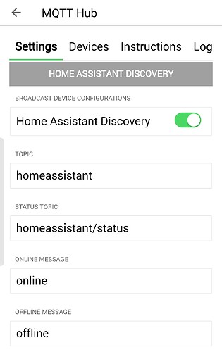

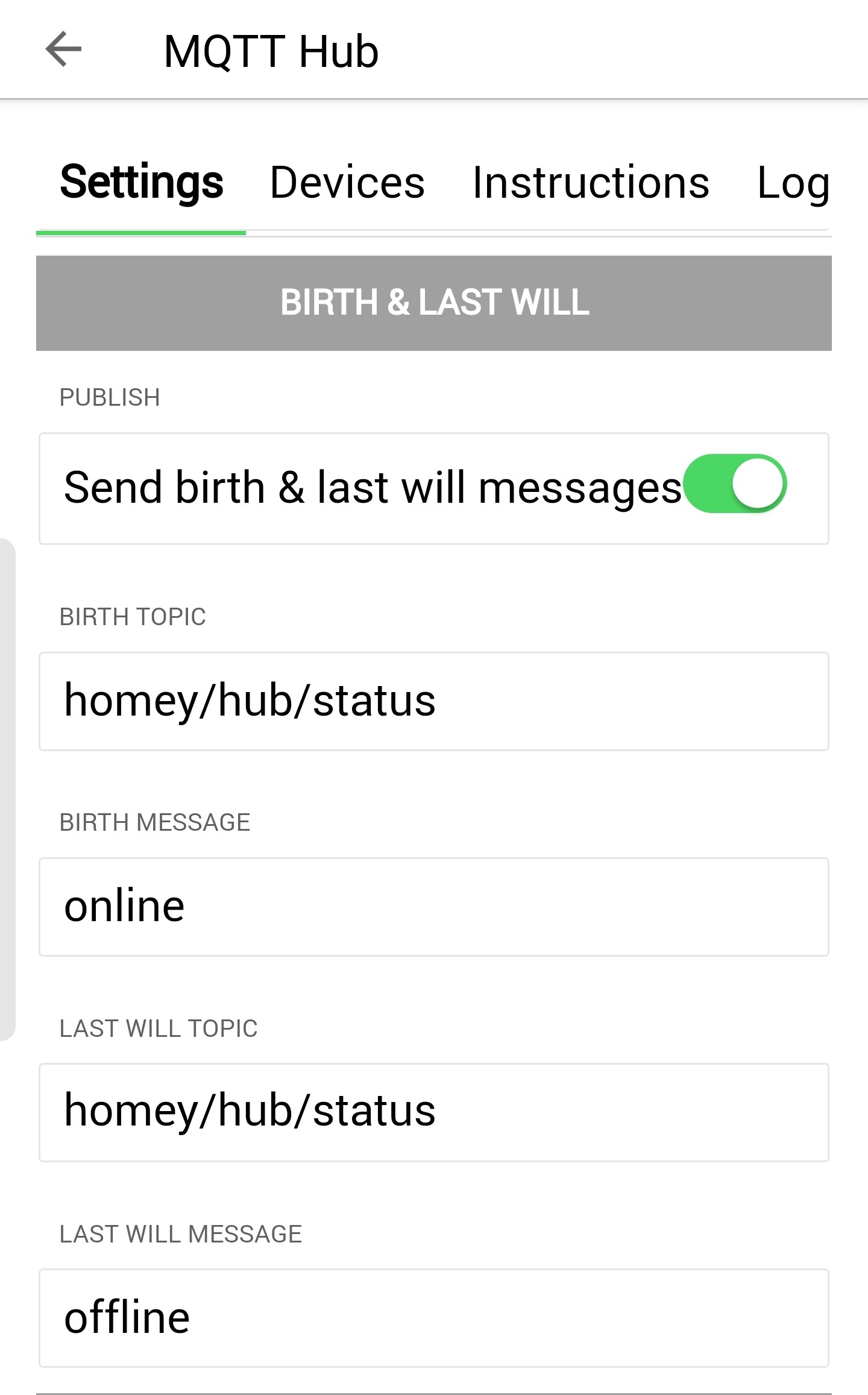

I use the so called Birth and Last Will functionality.
So when Homey or HA comes (back) online, this gets noticed and then a broadcast is started.
Homey:
HA (I changed the topic to homeassistant/status)

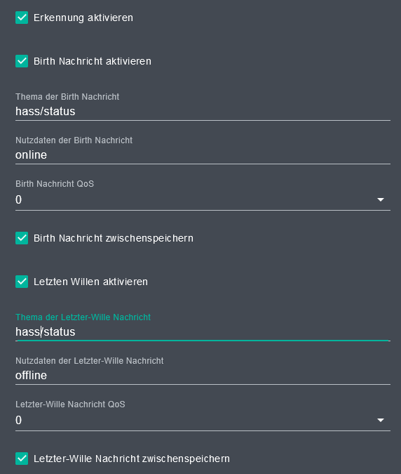

I’ve checked my config and it seems to be ok.
HA:
Homey:
So HA should send hass/status in restart and Homey-MQTT-Hub should react on it and reconnect (or resend all device attributes.
It seems, that the MQTT Hub reacts on the HA status and is boradcasting the data:
But even with this broadcast it’s not working. The devices in HA are only refreshed if the value changes in Homey.
Example: the first valve got updated in Homey and it’s synced with HA. The others are not visible in HA after the broadcast.
To get all states visible in HA, the MQTT hub app needs to be restarted.
