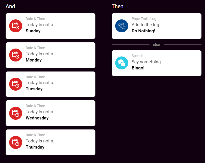

Would this work?
By th way, this is the Geeky long variant to have more Or’s: (When you need to check 3 or more conditions with only OR’s and fe the days or dates are not consecutive)
as:
A or B or C or D
is the same as:
Not ( Not A AND Not B AND Not C AND Not D )
Thanks for the suggestions. Works great, saves me a Flow now.
