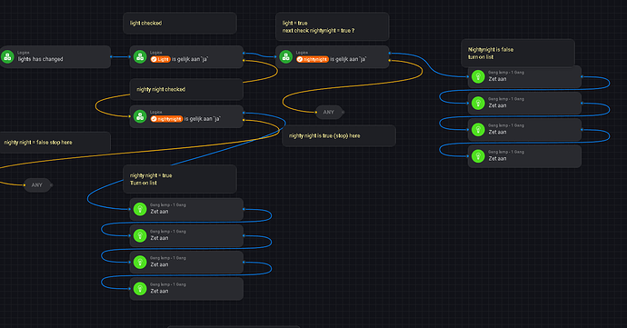

I made a DIY circular switch case using the advance flow to change radio station on a sonos speaker with a zigbee button check de printscreen. I hope this helps
aaah, didn’t know that an advanced flow could be triggered by multiple events (e.g. ‘flow started’ OR ‘right button was long pressed’ OR ‘left button was long pressed’).
I seem not to be able to get something similar done.
Does your flow really work ?
Yes it works, are you using a counter to switch to the case of your choice?
Share your flow maybe i can help
something like this ?
