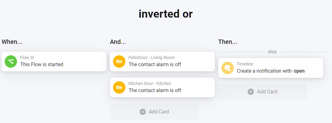

I’m trying to make a flow with more than three OR statements (if any of four windows are open).
Have you got any suggestions on how to solve this?
Thank you!
You could invert the conditions in the and section then add the action to the else.
Edit: I have just noticed when sharing the flow the Then section doesn’t show the else line. But in the flow I created, I dragged the action down so it is in the else and there is nothing above it.
What I do is put a flownote in the if to explain why I made an inverted flow. Doesn’t do anything but makes it more readable.
