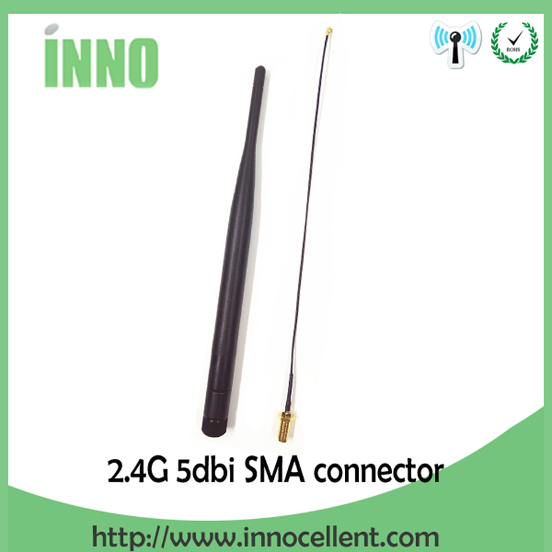

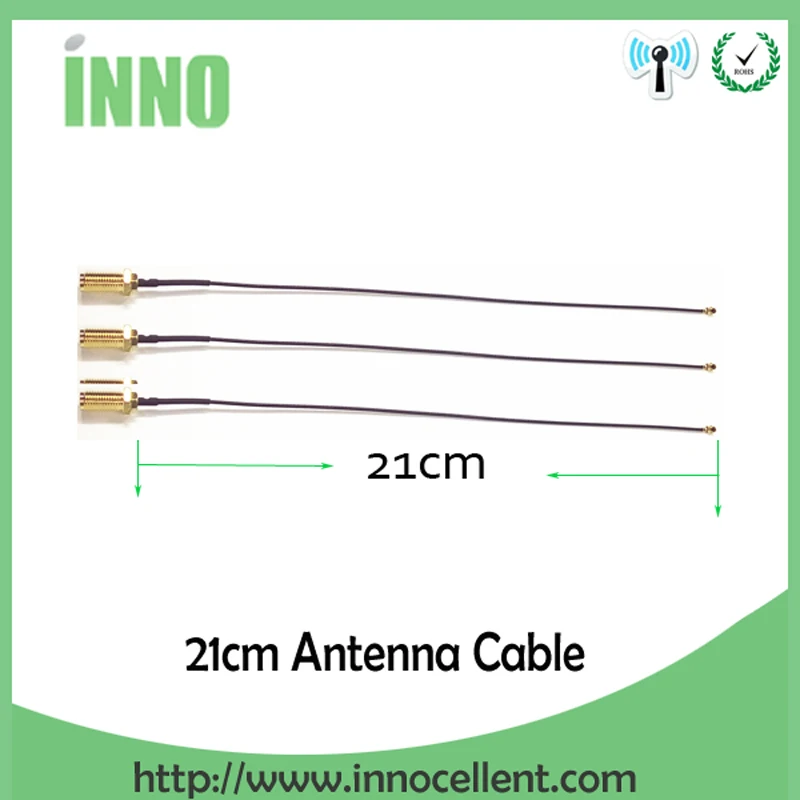

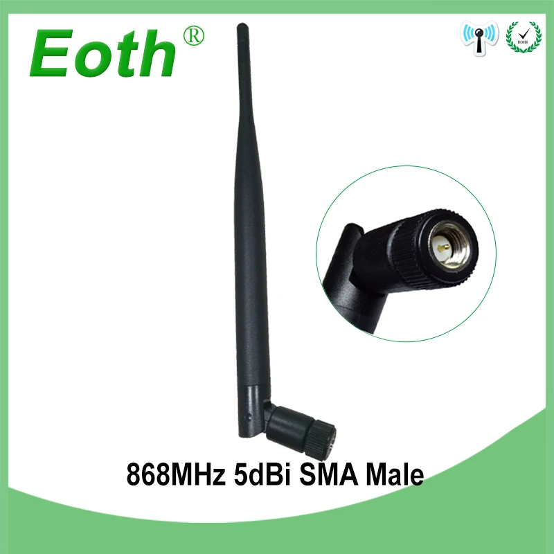

I ordered these:
Zigbee:
Zwave:
The benefit of these are that one has a male connector and the other female so no worries about swapping antenna’s :wink:
