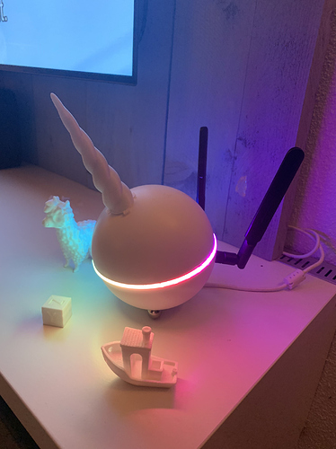

Decided to jump the badwagon and also increase my Homey’s range, as it was very bad in it’s original state. I have a very recently build house which apparently is isolated so well, that the z-wave signal wouldn’t even reach upstairs.
I followed above idea’s and the result is quite nice. I did damage the shell a bit when attempting to separate it, as it was glued pretty well and in the beginning almost impossible to get in between. But I just rotated that to the backside.
I haven’t fully closed her up yet, pending some last work on the inside and/or some last adjustments if results aren’t as expected., but boy she does look pretty now. Almost like a real magical creature…
The back antenna’s are the 2.4G ones for respectively WiFi/BT and Zigbee. The Z-wave antenna is actually inside the unicorn horn. :unicorn:
Wow! What can I say… my daughter definitely loves it!! I guess it balances out Homey. Is that horn 3D printed? You can perhaps have a tail where you can incorporate the back two antennas.
I’ll be curious to hear your feedback regarding the z-wave range.
Yes, it’s 3D-printed. :slight_smile: Actually, the model is part of a larger project; https://www.thingiverse.com/thing:956359. But it’s a pretty easy and relatively quick to print; hollow on the inside, just cut open the plastic of the ā€˜regular’ 868mhz antenna and put the insides right in. Then glue it shut on the bottom with the plug in the middle, and you actually have a remove-able Unihorn SMA antenna, haha.
