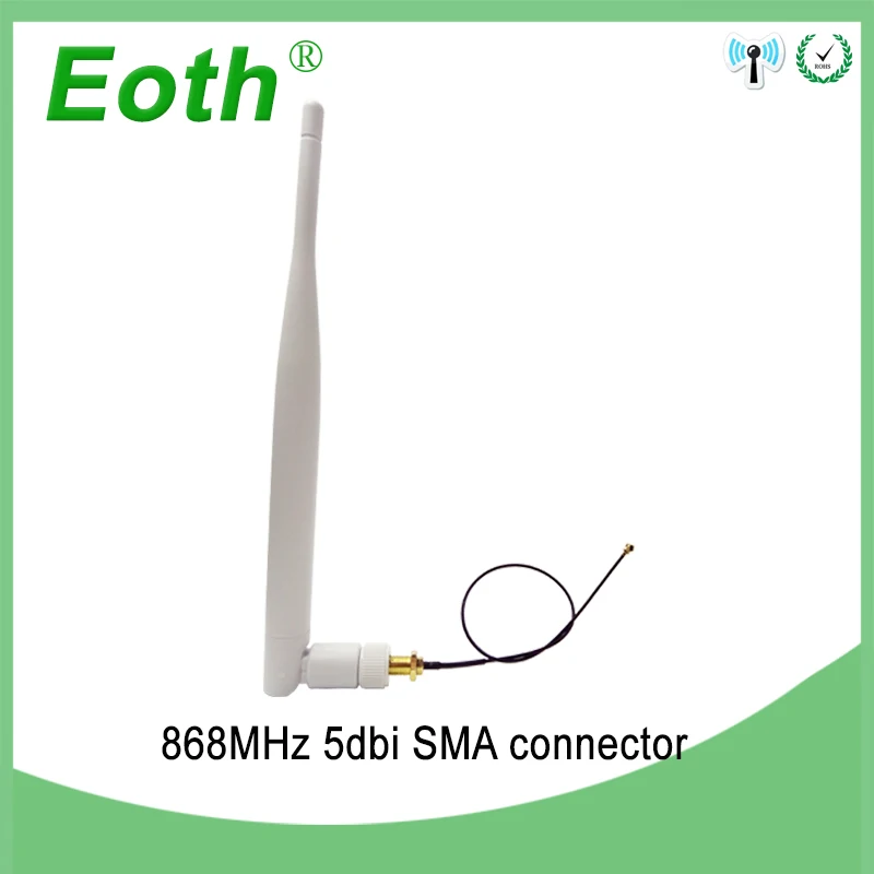

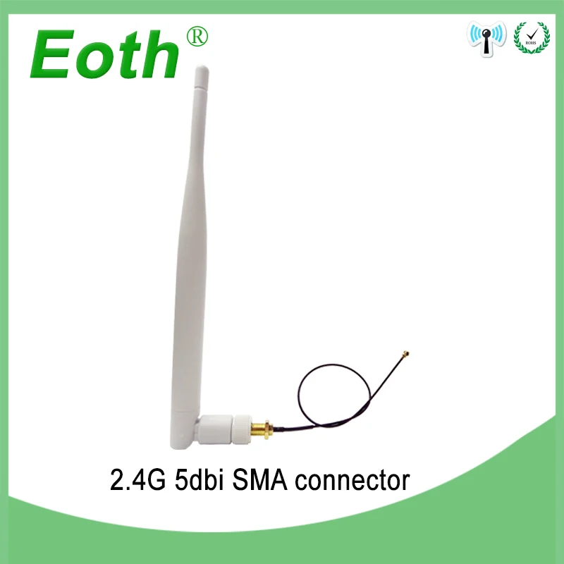

Together with @robertklep I popped the hood of my development Homey yesterday evening and installed two white Zigbee / Z-wave antenna’s…
One of the antenna’s still has some paper tape on it to distinguish the different versions.
Zigbee (2.4 Ghz) antenna used:
Z-wave (868 Mhz) antenna used:
