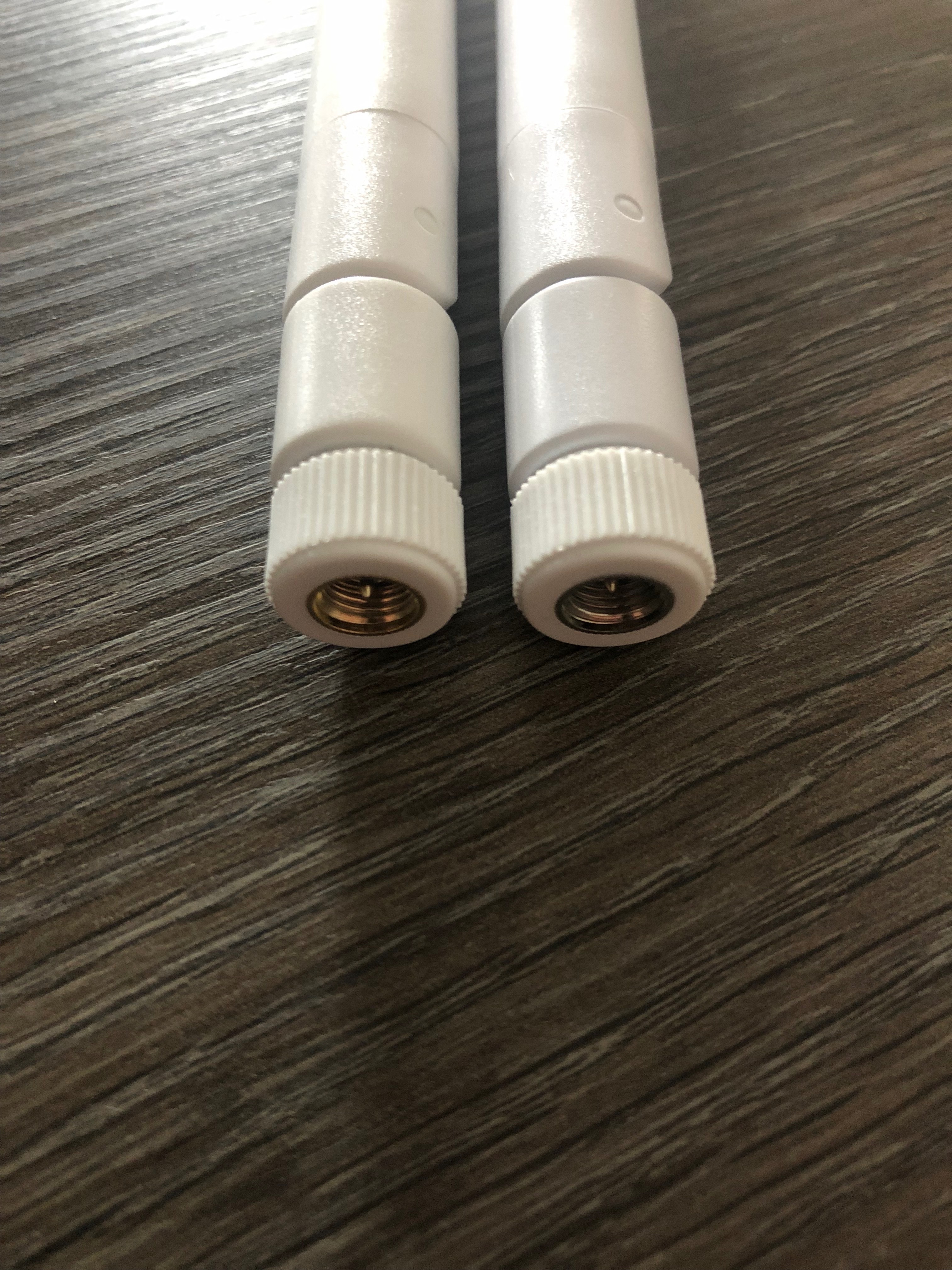

How can you be sure which antenna is 868 MHz and which is 2,4 GHz? The only difference I can see is, one has a ‘gold’ connection point and the other is silver. Both look exactly the same (like I wanted) but I made a wrong decision with the type of marker (whiteboard makers ink easily disappear).
Left is gold and right is silver.
If you see a considerable drop in Zigbee/Z-Wave range, swap the antennas? Other than opening them up (which doesn’t seem possible), there’s no easy way to find out which is which (the active antenna element for 2.4Ghz should be shorter than for 868Mhz).

For 868 there should be a coil or a piece of pcb with copper lanes on it. The WiFi usually has a metal tube, sometimes with a coil or extra piece on top.
Did you order the ones mentioned in this topic? In the packaging with green elements on top bottom which include the cheap connectors?
Then they must be the same as I ordered. 2.4 ghz has a gold color, both 433 and 868 are metal colored.
Also when shaking the 433 you can hear the antenna coil. In the 868 and 2.4 you hear more of a PCB shaking inside.

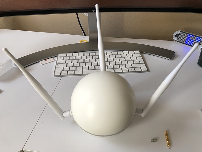

So finished my mod and so far I am impressed and very happy with the result. Especially the Zwave improvement is significant. I’m almost not getting any transmission errors anymore and the thermostat in the attic is even connected directly now.
I had some trouble opening the homey, it was glued very tightly so had to use a thin saw to create a small line between de led ring and the top dome. Then gently pried it open. Did some cosmetic damage though.
Soldering the Zwave was easy, as connecting the Zigbee. I also removed the 433Mhz antenna, but then all is left is a hole, because I wanted to keep the original antenne just to be safe/sure. In the hole the solder needed to be removed before you can connect the very thin cable for the new antenna. Eventually I used a little piece of the original Zwave antenna as a filler for the hole. Then I soldered the wire to this little hook and but some shrink wire over it.
