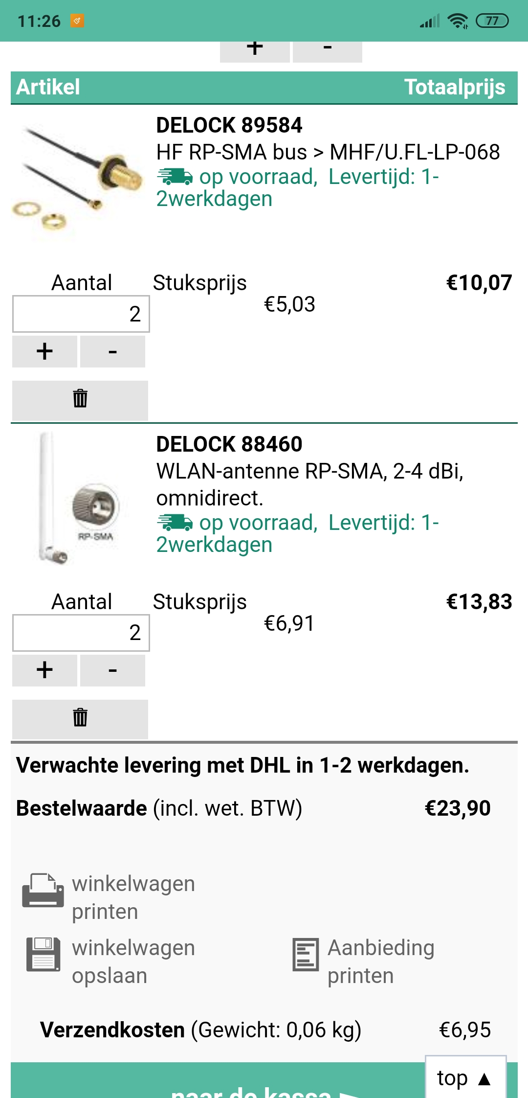

So, I found this one:
https://www.wifiversterken.nl/p/wifi-antenne-delock-88460?pid=10053580563.5603&filter=16102
Edit: only this on is rp-sma. So, female. Need to look for the normal SMA version.
It is 2dbi and omni directional and it has a VSWR of 2.0
I don’t know how far the signal goes as its only 2dbi but I think I will give it a try.

That is what I ordered. Both for WiFi and zigbee. From what I saw, the quality of this looks better than what I received from Aliexpress.
So let’s wait and check it out!
