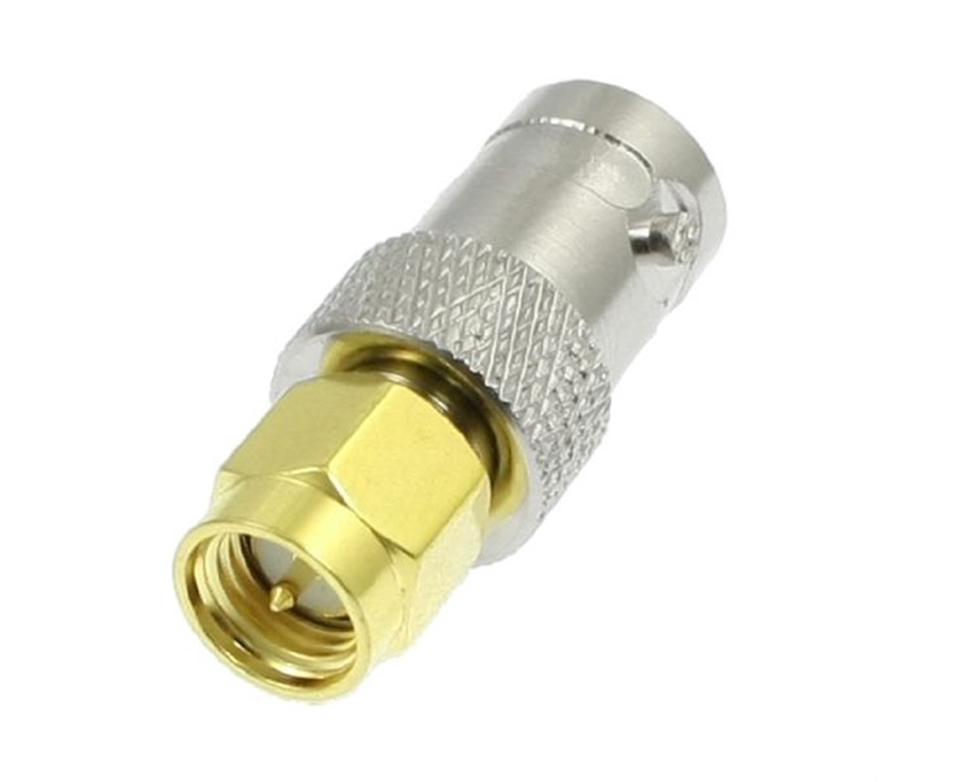

How about the part that goes inside Homey? Does this antenna come with it? Connector and cable that solders onto the MB.
It’s a BNC connector so I have bought a short cable with a SMA, that I will mount onto my Homey, and also a SMA to BNC adapter.

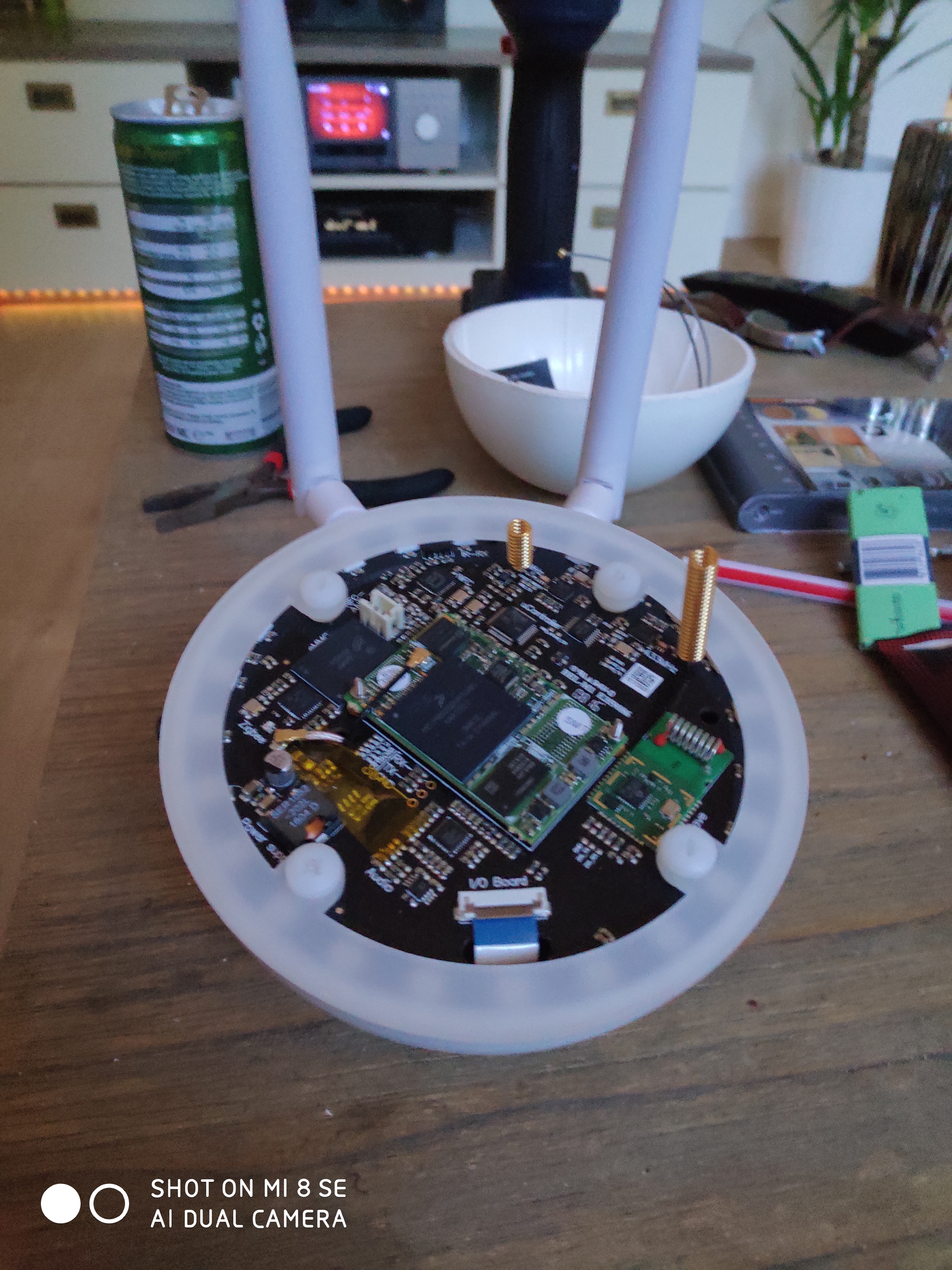

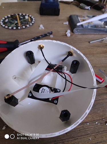

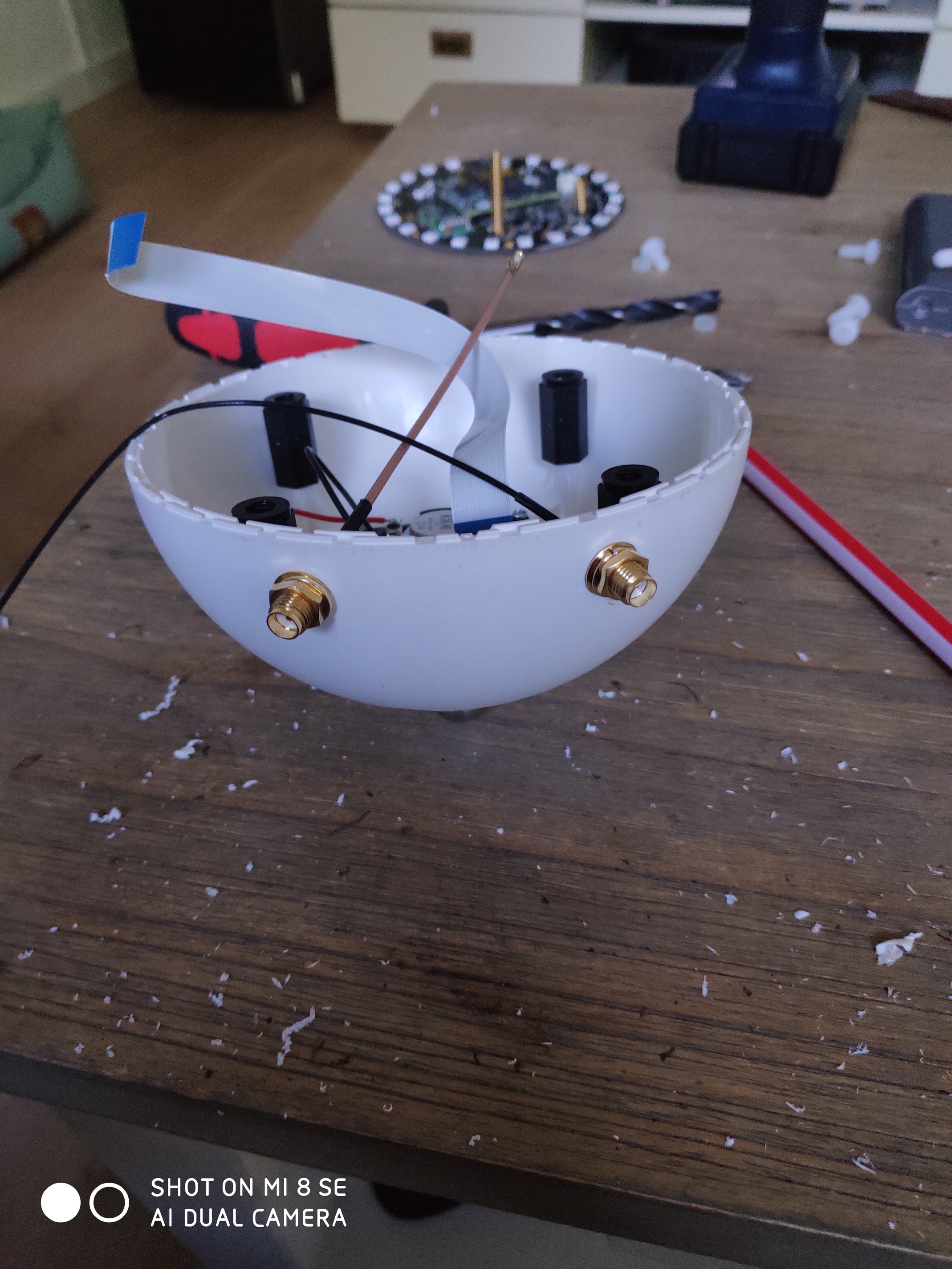

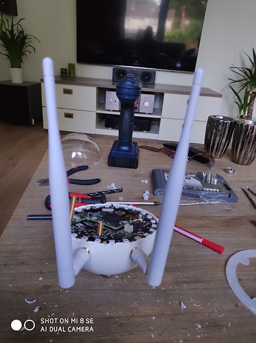

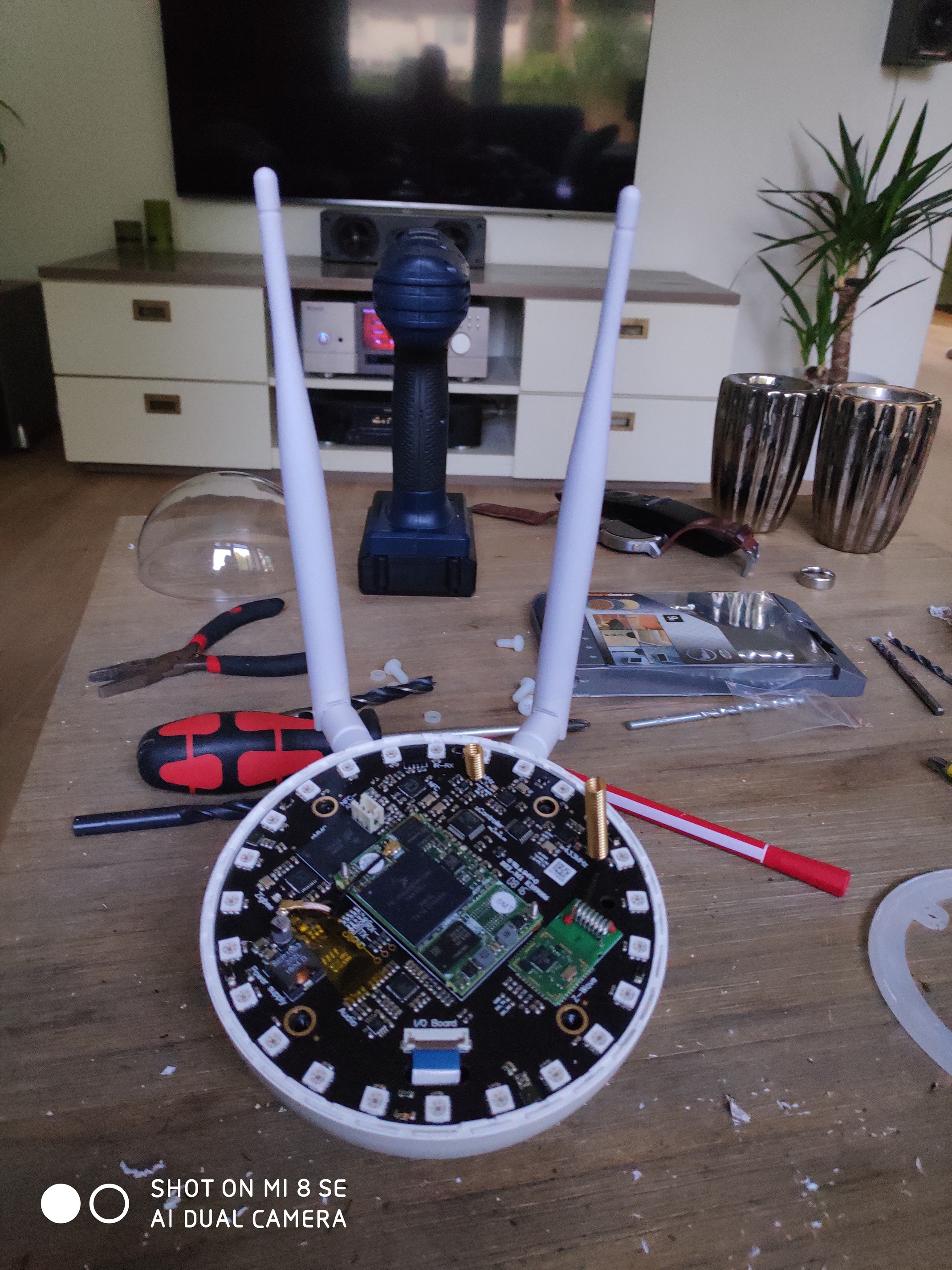

Hi guys,
I did the MOD too! Only for WiFi and zigbee. The rest is fine/or I do not use it… Now let’s wait too see how the results are!
Some tips:
-Make the holes for the antennas not too low as you want them to aim up nicely. And not to the wall.
-place the white ring back up side down so you do not see any glue residues when you use a transparant dome as I did.
U have used these parts:
€ 0,63 23%OFF | RF IPX/U. FL Schakelaar SMA FEMALE Pigtail Kabel Voor PCI Wifi Card Draadloze Router Antenne WiFi Pigtail Kabel IPX naar SMA Extension
https://s.click.aliexpress.com/e/BzUK7Zmg
(15 cm)
€ 2,74 8%OFF | 2.4 Ghz antenne Wifi 5dbi SMA MALE connector wit 2.4 ghz antena Omni-Directionele Router 2.4g Antenne + RP-SMA Mannelijke Pigtail Kabel
https://s.click.aliexpress.com/e/2Vk6tGli
€ 0,62 10%OFF | Kerst Transparante Bal Dozen Snoep Romantische Ontwerp Kerstversiering Transparante Bal Kan Open Plastic Snuisterij Ornament
https://s.click.aliexpress.com/e/bhm1IbjE
(12cm)
