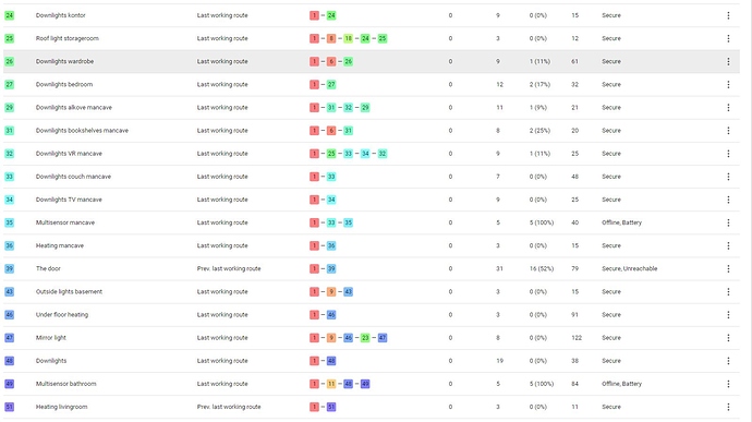

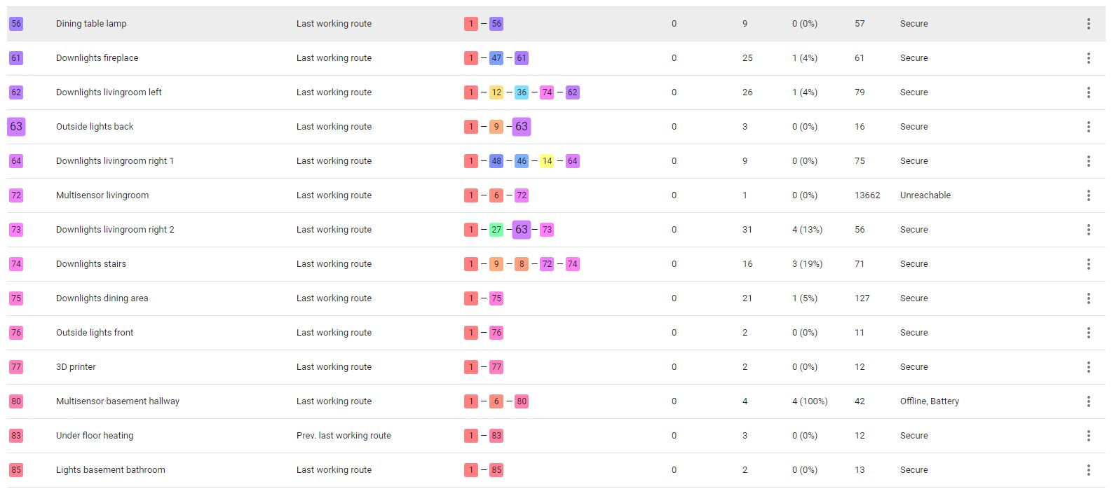

I’d like to show my mesh network after a week+ since my antenna mod.
Anyone had similar issues?
Almost all these nodes can be healed to a single hop, but it reverts to this after a short while.
Then this is supposed to be the best situation after a while…

When turning on the lights in larger rooms, with more than 5 dimmers etc. I’m lucky if only one dimmer dosent light.
The typical “All off” flows for away mode or night mode, I’ve been forced to have more than 30 seconds total in delays to maximize the chances of all lights being turned off. But still the standard is it still being 3-4 lights throughout the house still being on afterwards. Sometimes even showing in the app as being off, but really still on.
And The door (Danalock v3 node 39) now has a direct link, but still dosent work half the time.
I can heal the entire network, and go around using single lights etc. and everything is fine, but as soon as i run the bigger flows, it all goes haywire.
Hmm, that is nasty. You can try to place Homey somewhere else or maybe try another antenna. I have experienced that the inside of the antenna’s can differ depending on where you buy them.
Just for info: the healing command does nothing more then to force a device to look at the nearest neighbor.
But since it is dynamic, the route can change due to interference or changes in the mesh. I had severe problems when i put 2 Coolcam plugs too close to each other at some places. The plugs didn’t respond by turn or not at all together and some other devices who used them as a route also acted weird from time to time.
Also, switching a routing device completely down (no power) has the same effect. The mesh suffers from the fact that that device is suddenly gone and will rebuild.
