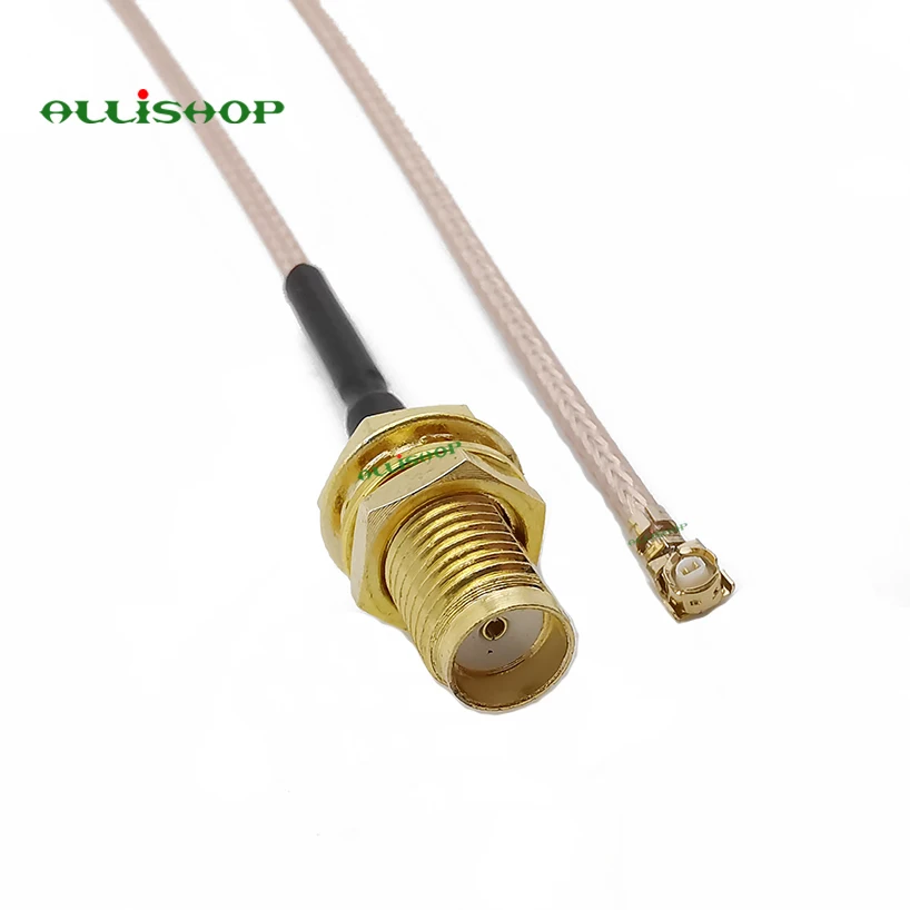

Angled connectors:
And if you want better shielded and more sturdy pigtails than the ones with the antenna’s (in various lengths):
