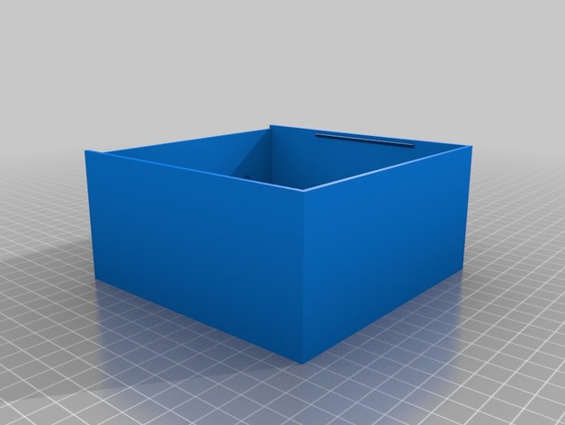

I Just uploaded v1 of the case to Thingiverse you can download it here, I did not yet print it myself. but have fun with it.

There is some free space underneath the PCB (20mm) I guess you could fit a powerpack there. but why not use an external powerpack when you want to move it around? much easier when you need to charge it.

We definitely need to include holes do lead antennas outside. A must :slight_smile:
The holes are there (3x) evenly placed on the backside. I don’t make them throughout the case on purpose. Now you van drill as much holes via the markers on the inside as you need. So if you look on the inside of the case you Will find 3 hole markers.

For those who wish to add power packs, i would suggest designing and making another “addon” case to house your specific battery pack. Maybe something that sits underneath this case that it will sit into. Keep this case simple i think.
I would suggest adding some sort of holes or ability to add a clear plastic insert somewhere on the front so you can still view the LED rings. As these often communicate things that are going on on the Homey.
It would be good to have options for RJ45 connection and 3.5 connection to IR extenders, but as Homey, and even the new “pro” version dont support these yet, maybe no need.
But maybe add a 3.5 connection or 2 wire terminal so you could possibly (and I say possibly as I am not sure if this would work) you could wire in the NFC reader to, then add the NFC reader elsewhere in the home.
But great work guys, if you do produce one, please take pictures and tell us how you find it works. I’ll purchase one from you also.
  • Holes for clear led/ir window, probably in v2
  • Hole for RJ45 connection no point for current homey, as there is no wired ethernet interface on the PCB.
  • 3.5 connection to IR extenders, your free to drill holes as you like :slight_smile:

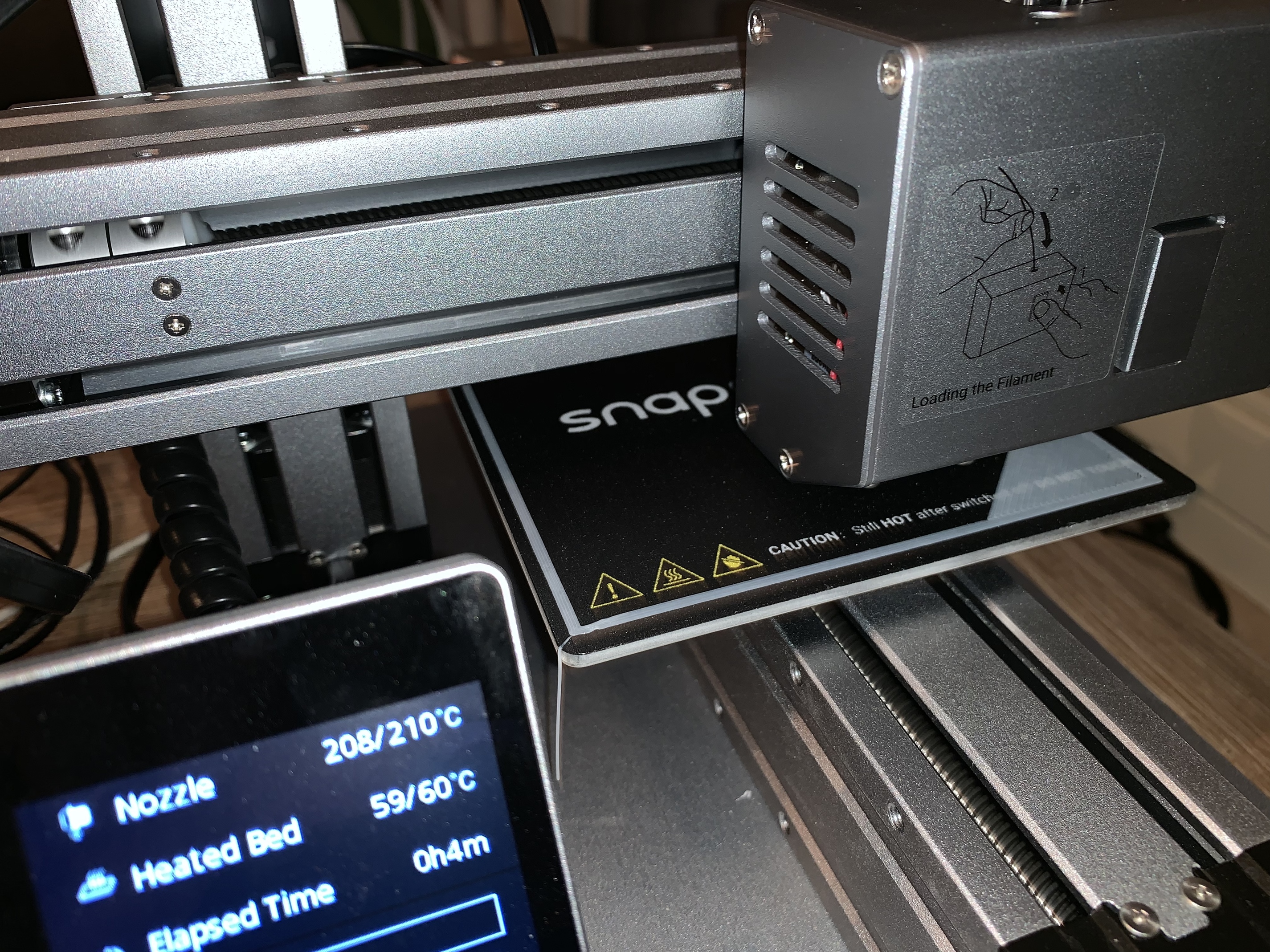

Was trying it yesterday, but I have some difficulties with my 3D printer also. When it’s printed I’l let you know. printing the cover should take about 2 hours, the case would take up to 16 hours (fast print settings :joy: ). PLA needed about 120grams according to my slicing software.
What is your infill? I mean the won’t have to endure lot of forces so 20-30% should be plenty.
20%, if adhesion would be OK. hopefully resolve the adhesion of first later problem tonight.
What temperature are you using to print the PLA?
I own a Snapmaker 3D printer, my temperature settings are:
Initial Layer:
  • Nozzle temp 210
  • Heatbed temp 60
Rest:
Nozzle 200
Heatbed 50
Print speed initial layer 20mm/s
How does the not adhesion look like? Maybe you are missing a little bit on the feeding rate to ensure they get ‘smooshed’ better together ?
