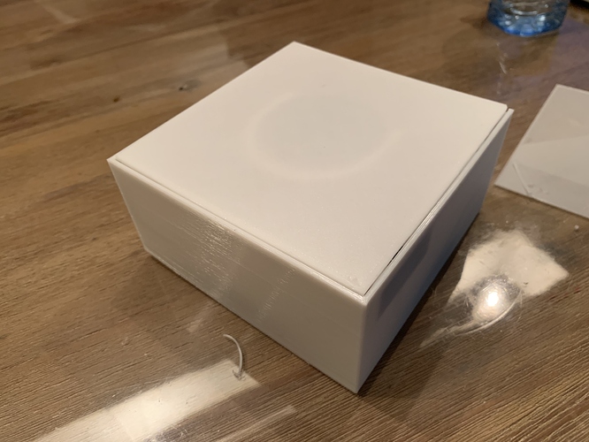

Cover Printed!
Jeeeuj!!!
printing the case
Good JOB!
Did you fix the adhesion problem?

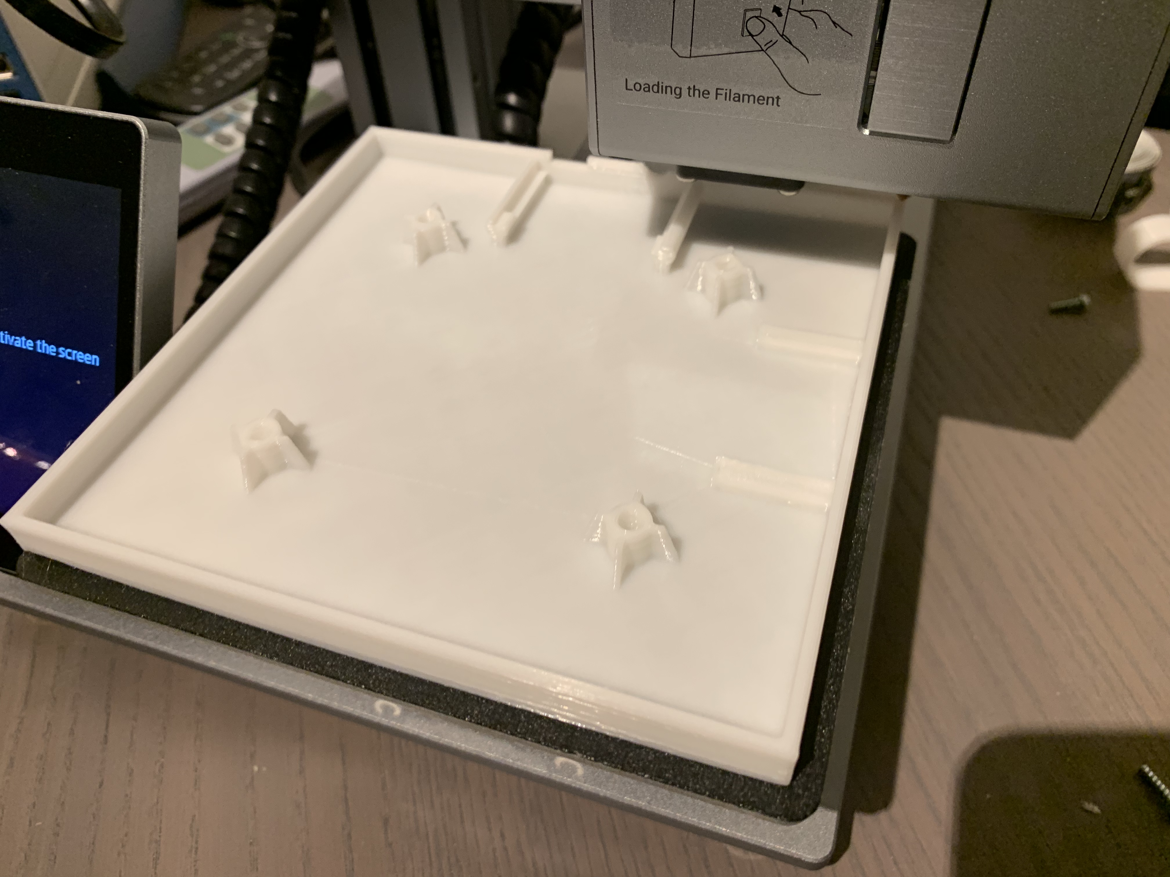

The case has also printed fairly well, I had to increase the size 1mm, because my printer refused to print it at 124mm. Quick measurements show that the model seems to be OK by means of measurement. the PCB surely fits within the case. hopefully the PCB support are aligned well. Try to fit the components tonight. Need to adjust the lid with sandpaper because it was printed at 124mm dimensions.

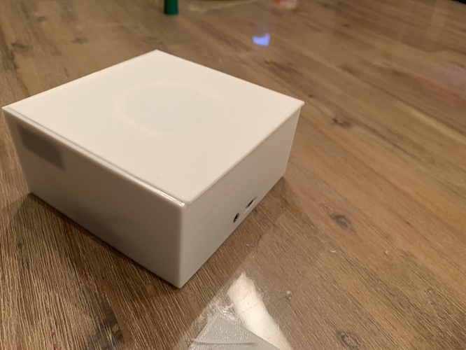

I’m very pleased with the results, only minor adjustments to the design are required, will make them as soon as possible. due to warping of my 3D printer not all corners are 90 degrees.

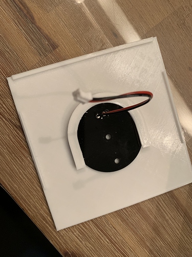

  • The support structure for the PCB is a perfect fit. (need something to secure it.
  • The structure for holding the usb/audio board works very well.
  • speaker mount is very basic. but does the job.
  • NFC antenna is a tight fit, but works well.
Only the hole for the USB port needs some adjustment, 2mm out of place + needs 1mm more height.

Current Case on Thingiverse is 99% ready, only hole for USB is misplaced 2mm to the right. speaker mount is very basic but you can screw the board on it. Already fixed the usb hole in the 3D model. only need to find some time to make the speaker mount better.
