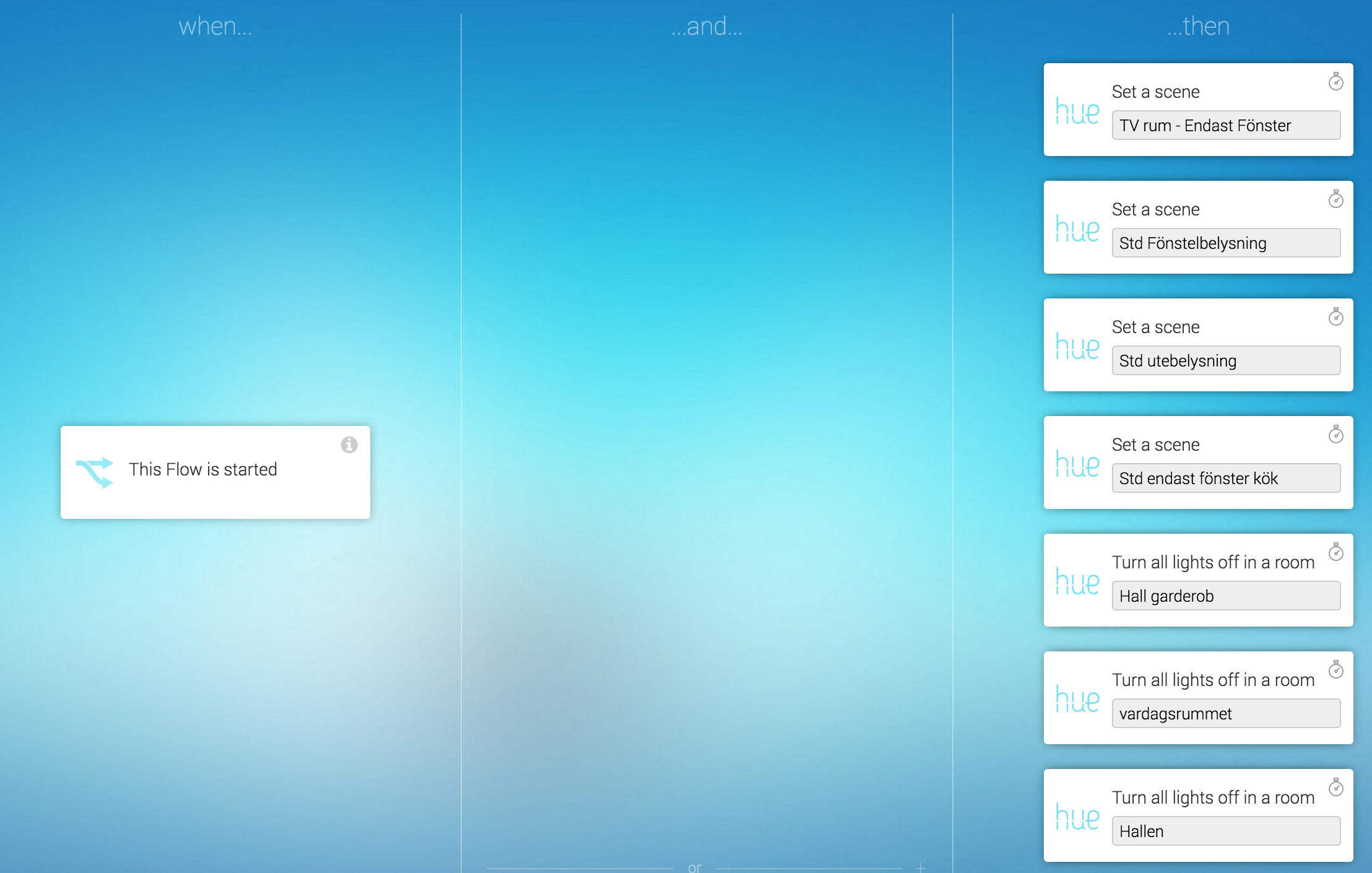

Thats actually what I’ve done. The problem is that some of these individual commands run by this flow printscreened below gets missed some times. This particular flow sets a few lights, and turns off a few. This flow runs every day, and about 1-3 times a week, one of all the commands run by this flow gets missed.
