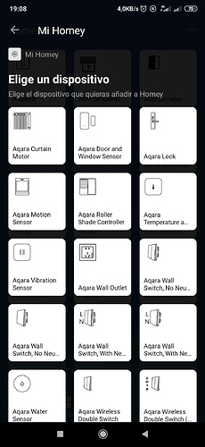

The devices associated to the hub do not appear automatically, you have to add them manually as usual
+>Mi Homey>device you want to add
Thanks!
So, devices added to the gateway need to be added again in Homey. Does that mean you actually pair them again??
Example! A temp sensor works with the gateway. I want to see it in Homey. How do I do that?
I install the gateway. I now have to add the device in Homey too? How?
Sorry for the questions. This is frustrating me…
Yes, you need to add them to homey. You can use them in homey and in mi home.
To add them go to devices> click in + (top right)> mi homey> and select the temp sensor.
The standard process to add devices.

In ‘devices’ I tap the ‘+’ and select a temp sensor (which I have several already paired to the Xiaomi gateway)
The pair screen opens - I now would expect a pair instruction - and closes within a seconde with the comment ‘no devices found’ .
I am lost again :wink:
You need to add the sensor in mi home app before.
