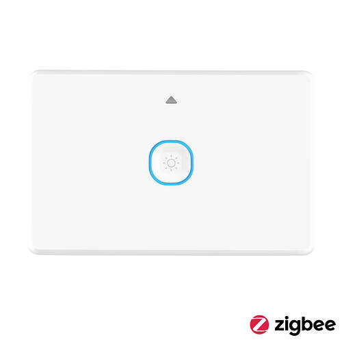

Yes, I use this model for that exact purpose - you just need to ensure the lights are dim compatible.

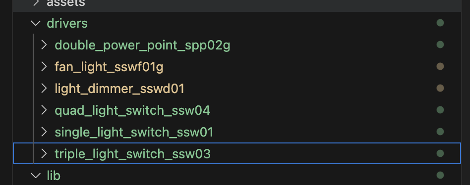

This is the device target for the next release of the App
I’m not sure I can correctly complete the quad light without the device interview, but will include support for it and can update any corrections as I’m basing it off other sources
Looks good, hoping to have everything wired in over the next couple weeks. Also happy to work with you to develop the app once I get my homey. As I think Mercator will become increasingly popular with Homey as more people touch into home automation.

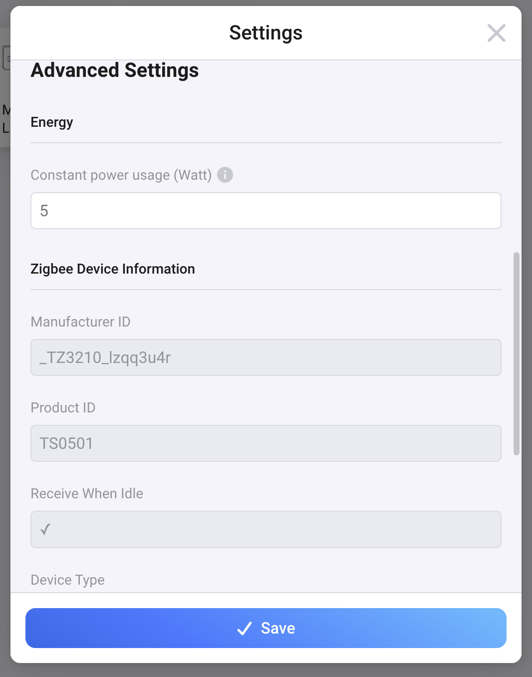

I will need to know the manufacture ID and product ID, which you can get from the settings of the device if you add to Homey as an unknown Zigbee.
And if you go to… https://tools.developer.homey.app/
Click on Zigbee and then on the right side, do an Interview of the device (wait 10-30 seconds) and PM the discovery data so I can make sure the clusters match up. I think I know what they will be, but won’t know the manufacture ID and product ID
