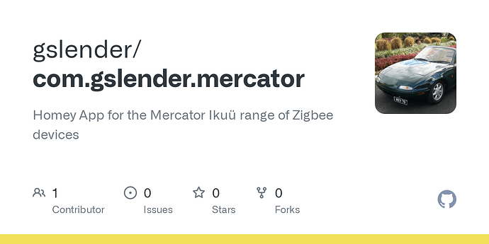

App for Mercator Ikuu is finished :slight_smile:

Okay, so have started the app, and early days, but WIP and I should hopefully get something working soon as the dimmer (which I also have) is fairly easy. I’m starting with the fan/light switch as I’d like to get that working as I have them in a few more places than the dimmer.
I actually have this Light Dimmer | Ikuü device instead but I hope that it works the same. If you can, can you grab the Interview log from your Homey for your device? (just add the device and run the Interview on this page Homey Developer Tools)
