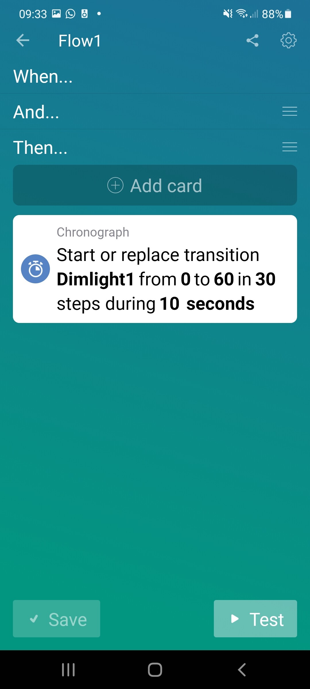

I have a WALLI DIMMER ( named WD) that when it is switched ON must bring light to 60% in 10 seconds slowly like in 30 steps.
So i understood it need 2 flows ?
FLOW 1
When → WD is turned ON → Then → chronograph card (start transition Dimlight1 from 0 to 60 in 30 steps during 10 seconds)
FLOW 2
When → chronograph card (transition Dimlight1 has reached a step → Then → WD Dim to Transitionlue
BUT THAT IS NOT WORKING

I think the transition is incorrect, because dim values mostly range from 0 to 1. If you want to dim it to 60%, you should choose 0.6 in the transition.
It would look like this: from 0 to 0.6 in 30 steps during 10 seconds.
One thing to be aware of: 30 steps in 10 seconds means one step ever 0.333 seconds, which will likely cause Homey to automatically pause your flow because it gets triggered too often.
I did change from 60 to 0.6 and i set up 10 steps instead of 30.
