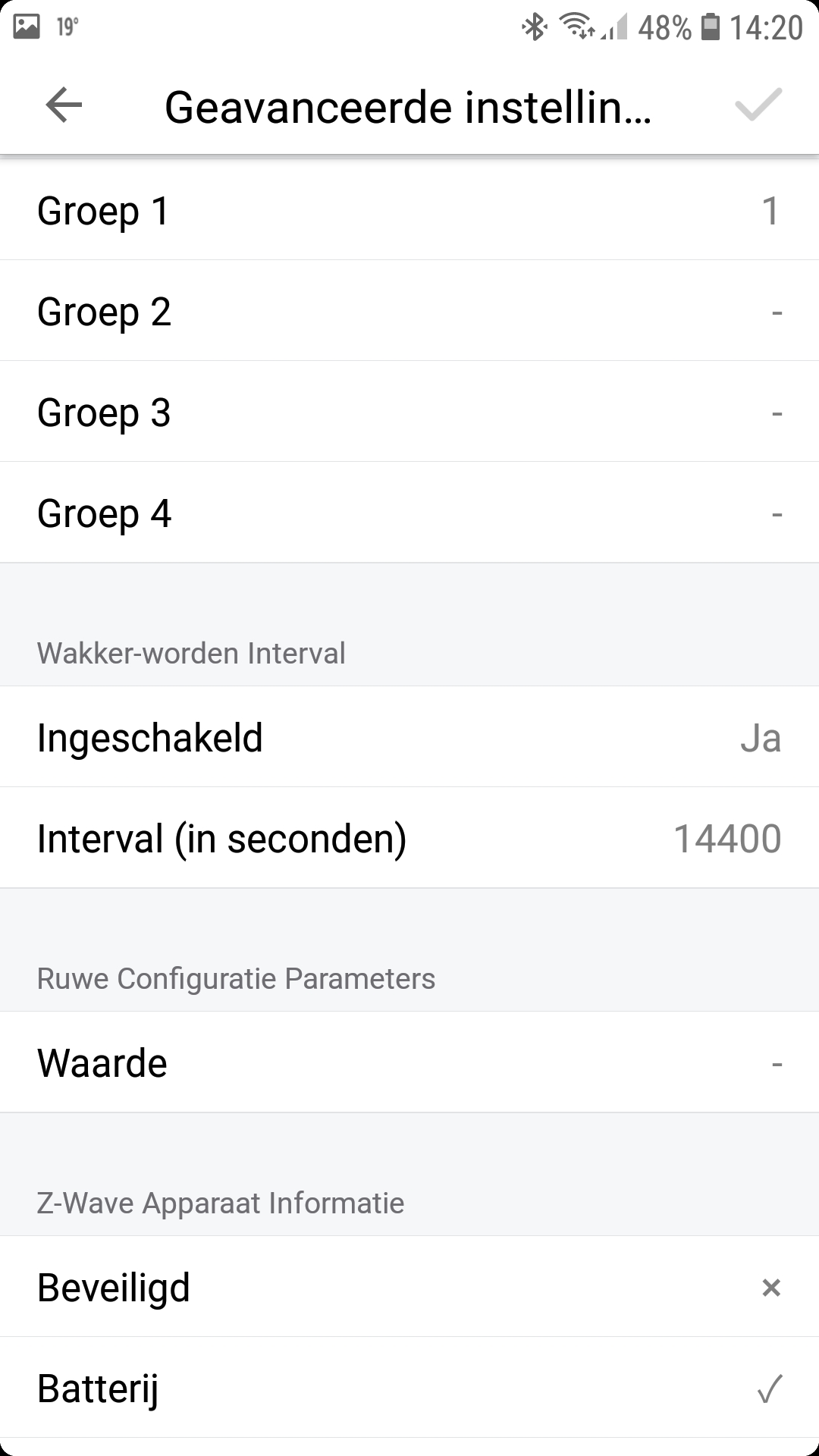

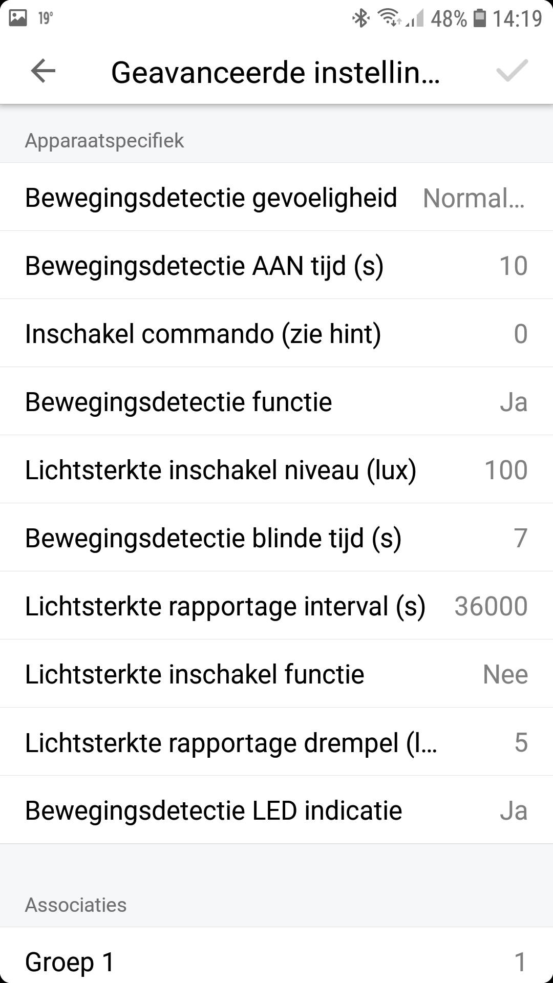

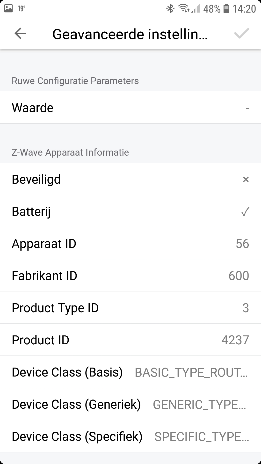

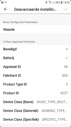

Hi Fred,
Can you share me your settings for the motion detector from neo Coolcam v2. Mine is not working properly at the moment. Did you do anything to update the firmware on these things?
Wendy
Wendy, This are my settings.
