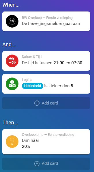

Below the screenshot of the 2 flows I have now to accomplish what I need.
I know the times are the same but reversed. But this is due to the fact that I cannot set seconds. Otherwise I would have let the time windows differ with just one second.
For the motion sensor I use a Fibaro Motion sensor V2.
I use the lux of the motionsensor
Roy thanks for clearing things up.
now I understand why It did not work as I expected.
There is no way of putting it in one flow because the AND and OR card always go to the THEN card if true.
